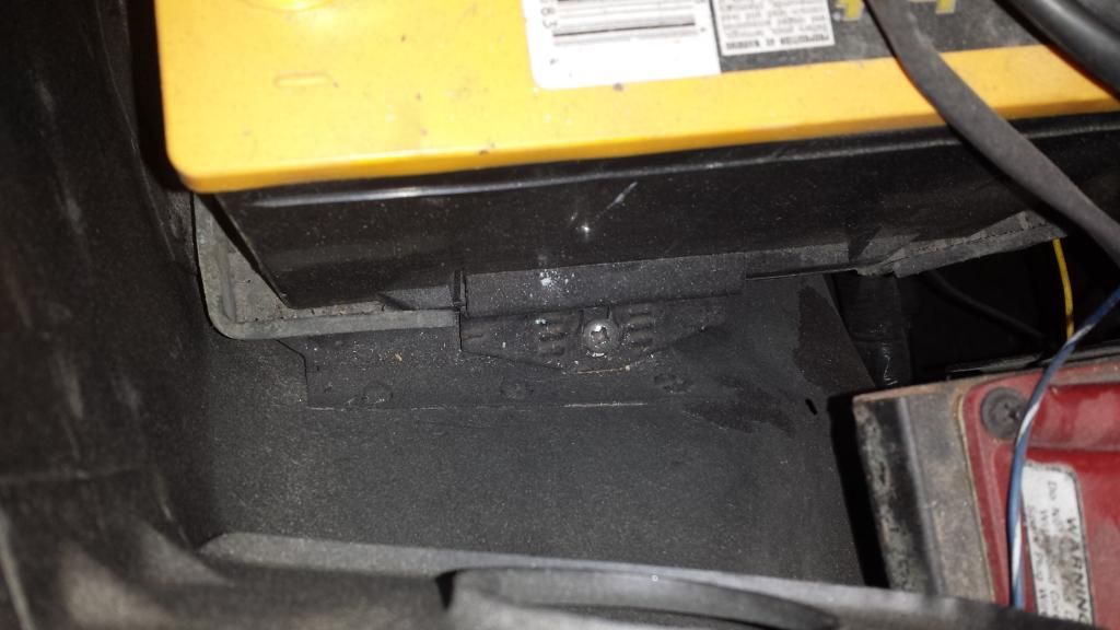

winstonusmc Posted December 30, 2014 Share Posted December 30, 2014 I fabbed up this with 1 inch angle steel from Home Depot. I had to go with a different setup due to the Civic size battery Quote Link to comment Share on other sites More sharing options...
