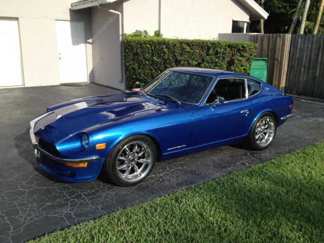

The look was exactly what I wanted.

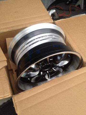

So I decided to trim the fender lip, rather than roll it, and have my Rota’s professionally widened by 1”.
Not being a big fan of downtime, and thanks to the fact that Rota’s are so economically priced, I decided to order another pair of Hyperblack 17 x 8.5 +4 RBRs and had them drop shipped directly to Weldcraft Wheels to have them widened 1” to the inside.
Meanwhile, I ordered a pair of Nitto NT05R 275/40/17.
A few weeks later, the wheels arrived to me.
Now I had a custom set of 17 x 9.5 + 29 (?)
One little thing I noticed though almost as soon as I opened the box…the rim seemed darker than the ones I currently had on the car.
I verified the color on the box as Hyperblack…but they were definitely a shade darker.
An email to Racing Lab explaining the issue got me a quick response…Rota changed the shade of their Hyperblack to slightly darker about 3 years ago…my current Rotas were about 4 years old…Just my luck!
Now I was faced with different colored rims in the front and the back of the car…sigh…I ordered two more of the “new” Hyperblack for the fronts so I could match all the way around.

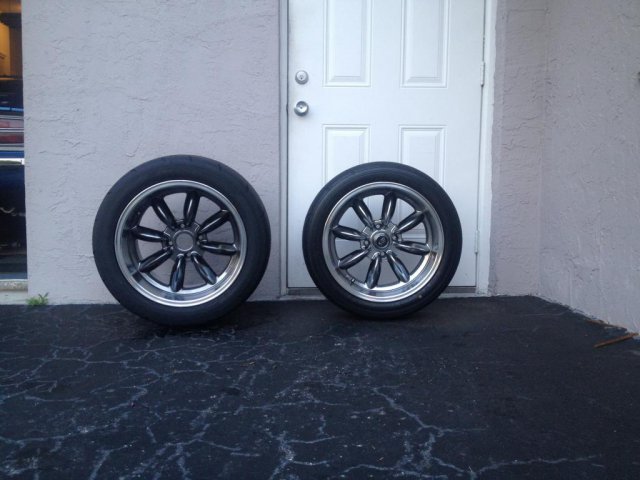

After mounting the tires, I compared them to my current setup.

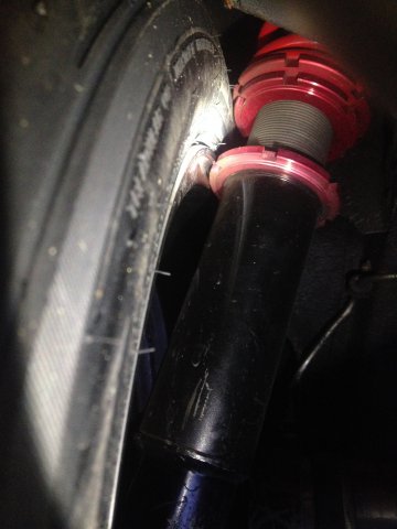

The wheel and the tire both touched the coil over, as anticipated.
Using some old 3mm spacers, I played with combinations and determined that, for some reason, I would need 6mm on the passenger side, and 10mm on the driver side. And, as a result, I would also need longer wheel studs.

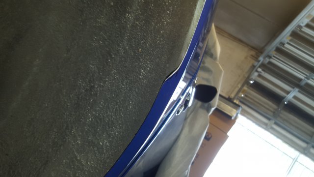

Then it was time to trim the fender lips.

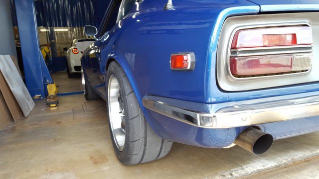

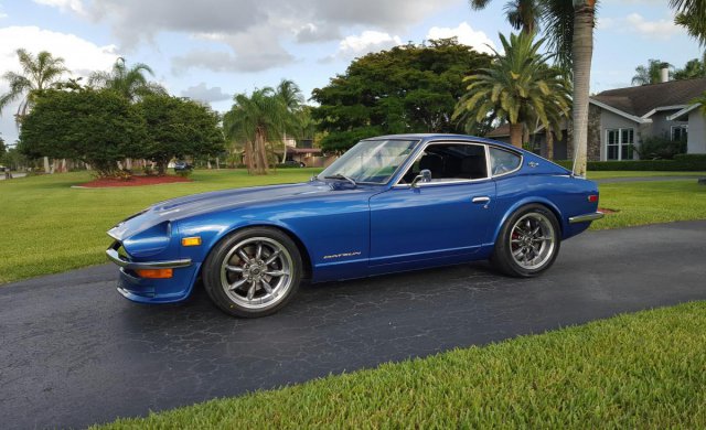

The finished product…
You can see the slight shade difference from the rear wheel to the front.
But the most important thing is…it works perfectly.
The car sticks now on full throttle and there is zero rubbing. I have launched from 1st, floored it in 2nd, and taken some high speed highway cruises over dips and bumps that would definitely cause rubbing if there were an issue…but there is none. This setup works like a charm!

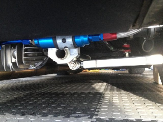

Because AZC LCAs are adjustable, I moved them inward as much as possible but it still wasn't enough, and I was limited by the length of the halfshafts which wouldn't allow me to move the arms any further inwards.
I ended up getting some custom shortened half shafts from Driveshaft shop, which allowed me to move the arms in farther as you can see here:
For those unfamiliar, the AZC LCA comes default at parallel to the ground, here you can see I rotated the arm's tube downward, which pulled the whole arm inward.  Then I had to drill through it and insert a retaining bolt to prevent it from rotating back outward (which happened several times to disasterous effect throughout this whole process!).
I did a mini write up in the Drivetrain forum, I'll look for the link.
The whole process was such an ordeal, I guess I tried to block it from my mind!  But nonetheless, it is important for anyone to know if they decide to try this.
