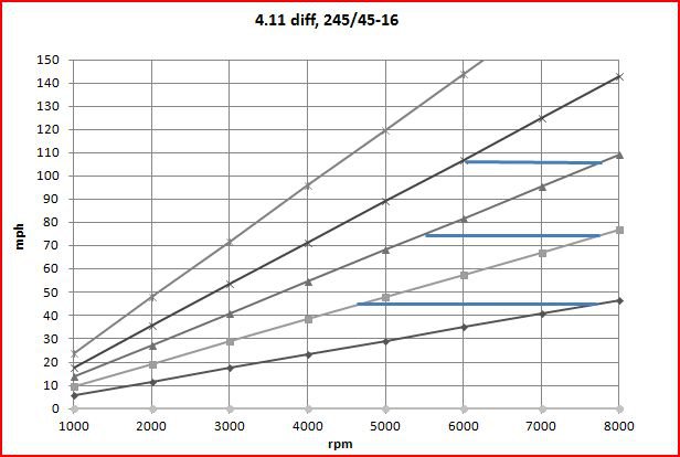

With my current transmission, differential, and rear tire size, the 7700 RPM works well to keep engine operating range in the torque/power making rpm zones for all gears I would use at the track:
Though again, this transmission will have to be a short term solution as the torque output is too high for it over the long term.

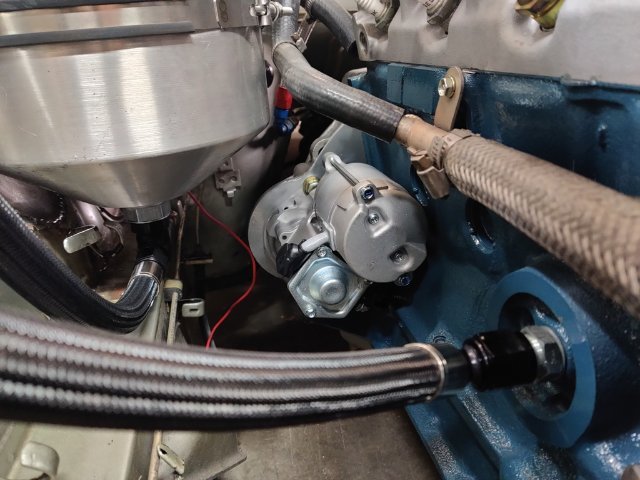

Nearly 8 years later, I have a replacement engine, which I received today.  Not much to see, but here are some pics:
IMG_20230731_175341.jpg.9c4a4c7b73bc6a1f16c636bf354946c5.jpg  IMG_20230731_175353.jpg.f6439de822cf85a73fff77b09b88e1b4.jpg
IMG_20230731_175413.jpg.24557e9fa5bbfbc699e22a3029b447ea.jpg  IMG_20230731_175428.jpg.72fea8e10e9e1823833ff0268f35e01c.jpg
I have a lot of work to do before it can be fired up in the car.  So, it will be a while before that happens.
This motor is very similar to the one I destroyed.  Changes are 89 mm bore, (now a 3.0 liter vs. 2.9 before), Intake valves are titanium (vs. stainless before), crankshaft this time is not lightened and knife-edged, and this engine will utilize a dry sump oiling system.
I have shelved plans for a 3.4 liter.  May never get back to that.
If I had it to do over again, I'd go with something much more "standard" and pay one of the L-series specialists to do it per their recommendation.  If this engine blows up, I will pay one of the well known L-series specialists to build a reliable replacement engine.
Here's hoping this one doesn't go boom.
