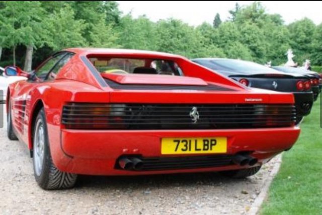

zeeboost Posted January 14, 2016 Share Posted January 14, 2016 (edited) Think testarossa Edited January 14, 2016 by zeeboost Quote Link to comment Share on other sites More sharing options...

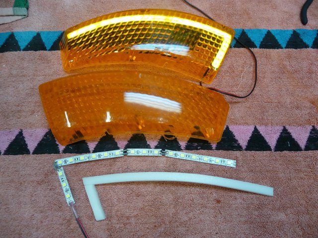

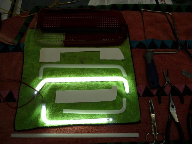

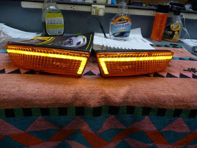

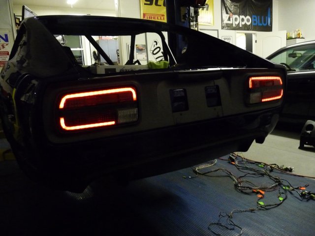

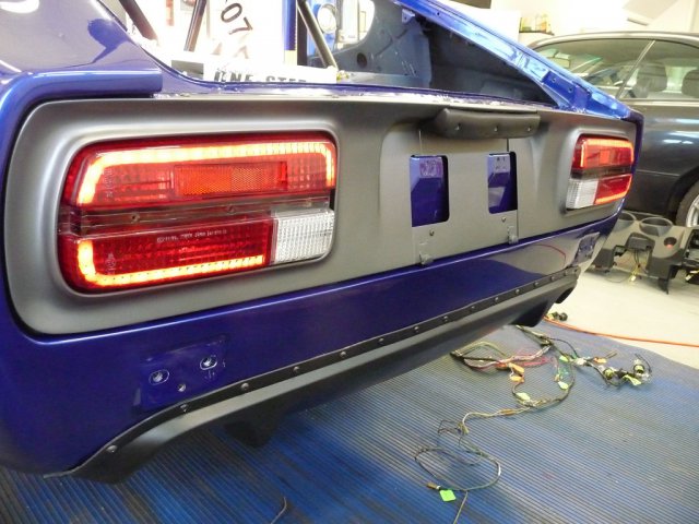

Litman Posted February 15, 2016 Share Posted February 15, 2016 Like this? Just finished fabricating these for my '71. Diffused light bar using LED strips attached to cut and heat molded pieces of poly cutting board (from Walmart - based on my investigation it looked like the surface texture would diffuse light licely). About three weeks worth of design, trial and error here. Quote Link to comment Share on other sites More sharing options...
1969honda Posted February 16, 2016 Share Posted February 16, 2016 Those look awesome Litman! Topnotch look Quote Link to comment Share on other sites More sharing options...
Wizzurp Posted February 16, 2016 Share Posted February 16, 2016 Litman, yes basically that, I've got a 280, I think it would be cool looking to do each of the four lights with a complete ring around them. Those look sweet though, nice work Quote Link to comment Share on other sites More sharing options...

Greeko Posted March 10, 2016 Share Posted March 10, 2016 Nice work Litman, I would be curious to see your parts list to get this done. Quote Link to comment Share on other sites More sharing options...
LanceVance Posted March 10, 2016 Share Posted March 10, 2016 Nice work Litman, I would be curious to see your parts list to get this done. +1, any shots of the cutting board material after modification? Quote Link to comment Share on other sites More sharing options...
Litman Posted March 12, 2016 Share Posted March 12, 2016 BOM was rather simple: cutting board, LED strips from SuperBriteLEDs, disassembled tail and front lights, soldering equipment, heat gun, adhesives plus some other secret ingredients covered under my filing. Just kidding. No IP filed, yet. Quote Link to comment Share on other sites More sharing options...
