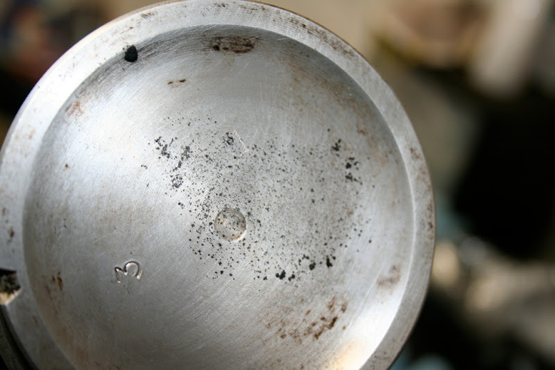

Chickenman Posted September 18, 2016 Share Posted September 18, 2016 (edited) Actually, machining the piston crown can be a good way to reduce CR with out losing any quench if done correctly. Just machine a dish in the center of the piston. Do not machine off the whole Crown top. By machining a dish in the center and retaining the Flat Top standard height around the circumference, you still maintain a squish area. Factory Nissan Flat Tops are approximately .023" above the block deck. Dished piston's are approx .020" below deck height. The .020 Negative deck height is what really drops CR and adversely affects quench. If the factory dished pistons had a deck height of zero, that would increase CR ratio a bit while still maintaining some quench. Welding the combustion chamber on an N42/N47 head is ultimately the best way. But it is not cheap. IMHO, machining the pistons can be a good way to drop CR and maintain some quench, while being more affordable. And it's a better method than just using a thicker head gasket. Try to copy the factory design and have your machine shop calculate the dish necessary. The factory pistons as shown below have a fairly large diameter dish. You can reduce the diameter of the dish to get a CR of around 9.5 to 1 and maintain some resemblance of squish. That should be OK on 95 RON. Factory Nissan dished piston. Note large diameter dish. Reducing diamter of dish, will help maintain quench. Edited September 18, 2016 by Chickenman Quote Link to comment Share on other sites More sharing options...
Chickenman Posted September 18, 2016 Share Posted September 18, 2016 (edited) You could even have your machine shop mill the piston top with an oblong dish. That would maintain all the squish area of the N42/N47 head. Examples of asymmetrical piston dish: Edited September 18, 2016 by Chickenman Quote Link to comment Share on other sites More sharing options...
