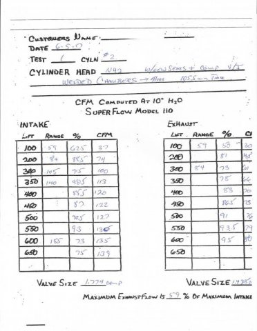

Nismospek Posted August 29, 2017 Share Posted August 29, 2017 (edited) With all the recent postings I was hoping to get some help trying to read out my Flow sheet. I picked off this head from Yahoo Auctions Japan. It was completely bare missing cam towers and about everything else. All I could tell from the photos was that it had been ported and that it had welded chambers. I decided to risk it and put a bid in knowing full well I might have just bought a new paperweight. I finally got it back from a reputable builder with new seats, Datsun Spirit Big valves and some unfurling of the valve area. I was told that different flow benches are like dynos. It seems that the flow bench used for this head maxes out at 160 cfm at 10 inches of water. Not sure how this coverts to newer type flow benches that read at 20 inches etc. Also not sure how this relates to max lift on the cams? Edited August 29, 2017 by Nismospek Quote Link to comment Share on other sites More sharing options...
turbogrill Posted August 29, 2017 Share Posted August 29, 2017 Seems like it's been ported for high lift aggressive cam. The flow numbers at low lifts looks small compared to high lift. Good if you have a high lift cam, bad if you have mild lift cam. But I am no expert. Quote Link to comment Share on other sites More sharing options...
ryant67 Posted August 30, 2017 Share Posted August 30, 2017 I'd get it flowed somewhere locally at 25 or 28 inches. If you have a stock head, get them to do that as well for a baseline. Then at least you can have numbers on a comparable scale to what others do. I'd expect the head to perform well though, fingers crossed for you! Quote Link to comment Share on other sites More sharing options...

Nismospek Posted January 11, 2018 Author Share Posted January 11, 2018 Found a nifty calculator. Decided to convert everything to 25 inches which is what I believe Rebello uses. 100 lift 58 cfm 200 lift 117 cfm 300 lift 158 cfm 350 lift 178 cfm 400 lift 189 cfm 450 lift 192 cfm 500 lift 200 cfm 550 lift 205 cfm 600 lift 213 cfm 650 lift 219 cfm Quote Link to comment Share on other sites More sharing options...

rossman Posted January 11, 2018 Share Posted January 11, 2018 (edited) The converted numbers are similar to my Rebello ported p90a head. The port is what Rebello called a "mild port." Custom Isky Turbo cam Intake: .535 lift, 278 duration, 114 lobe center Exhaust: .535 lift, 278 duration, 114 lobe center Ported head with 1 mm over sized stainless intake valves Intake: 201 @ 25" water Exhaust: 151 @ 25" water Edited January 11, 2018 by rossman Quote Link to comment Share on other sites More sharing options...
