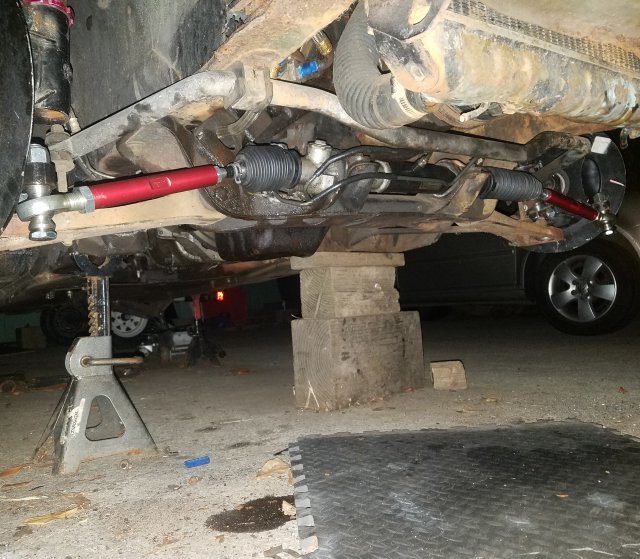

Invincibleextremes Posted September 19, 2018 Author Share Posted September 19, 2018 Swapped the rack over. Came out perfect, very happy with it. Here's the video overview. Quote Link to comment Share on other sites More sharing options...
takeuchi Posted October 4, 2018 Share Posted October 4, 2018 What specific parts are the inner tie rods and the steering rack? Will the same one work for left hand drive? Quote Link to comment Share on other sites More sharing options...
