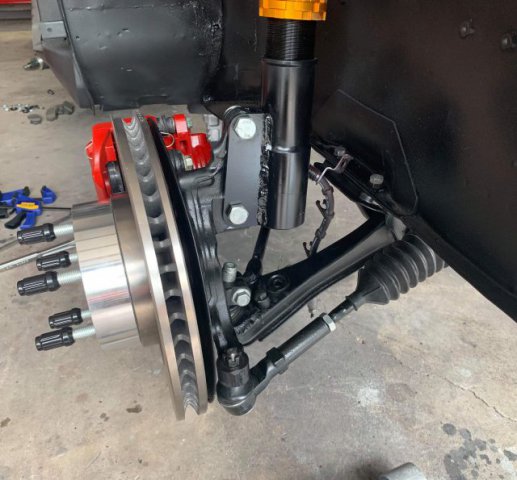

5 lug, 4 wheel big disc brake, and coilovers for pennies using 2014 mustang spindle and brakes
  • 2 months later...
Kyle is building a v12 swapped 2+2 and here's what he used up front...
2014 mustang ball joints.
2014 mustang spindles
2014 mustang GT 13.2 inch brakes
2004 mustang outer tie rods, we cut half inch off of them, they're fully threaded so we didn't see any issue with that.
1985 Camry inner tie rods.
2004 Subaru legacy steering rack.
He used silvermine coilovers. We rotated the camber plates and used them to add caster, and flipped control arms left to right...
Planning on using adjustable tension rods to move the wheels back about half an inch.

Just for clarification the new t3 tie rods are the exact taper needed for 2014 mustang control arms.  No drilling needed.  They bolt right up, gold car did exactly that.
And as to the caster, only way this mod works well is if the camber plates up top are rotated and used to move the shock backwards the same amount or more then the entire control arm is moved down below.
Or in David's case with the blue car, he did the caster up top but kept the control arms the same, and cut the fender to clear his tires since he flared the car anyway.
Here is a picture of the gold car and the t3 clearance style tie rods.
Link to comment
