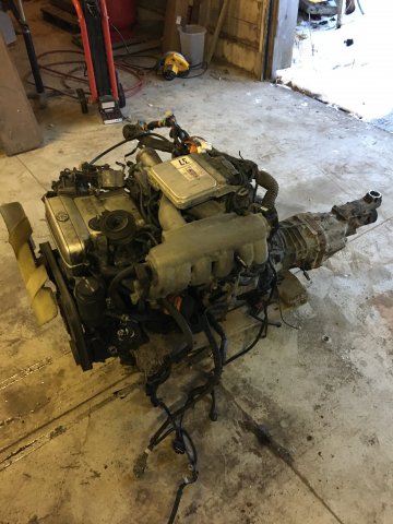

240zdex Posted December 8, 2017 Share Posted December 8, 2017 (edited) This thread was a should I stop my sbf build for a 2j build and now it's a slow and steady build for the future. engine will remain stock for a while till I can to afford to properly boost the engine with decent parts.(or a second engine while enjoying the car to keep the down time to a minimum) engine is from a 92 sc300 ran and drove. i chose to get a trans from a 04 g35 for the fact I had a few that were local and sub $150 price range(picked mine up for $100) i still need the adapter and flywheel kit and I think I'm going to use the mavericks kit $900 and if and when the 04 trans dies just pick one up from nissan for $1800 after the car is diving. engine and management im going to try and use a microsquirt as my engine management and some of the stock parts will need to be replaced to get it to work properly.(hopefully lol) i will add my updates when I get to this part in the build. worst case I will do the tt ecu mod and safc. (I still have the stock engine harness and m/t ecu if I can't make the microsquirt on the stock engine) fuse box my chassis has the stock fuse box in the center consol but was thinking about replacing and or adding a separate fuse box for the engine and mircosquirt. not sure what I should do here any input would be great. im going to be using a fuel cell because the stock tank was pretty bad and got a great deal on a 7 gallon cell. im thinking about running the fuel and rear brake lines on the driver side so when the turbo parts are installed the lines don't heat up and cause any issues from the exhaust heat.(I heard somewhere that was an issue not sure where though) Rear diff I have an r180 240z diff. im pretty sold on the tried and true r200 but thinking about other options for the long run and parts availability. iv thought about the r180 sti with adapter hubs,Ford 8.8,r230 but I think it will be hard to beat the price of an r200 swap. My main concern I have is making the drive shaft.I want to make sure I have the long term diff installed and ready to rock before I make the driveshaft and that's why the r180 subi diff is sounding good because I could get away with making the drive shaft now with the stock r180 and upgrading later down the road. Suspension I'm all kinds of lost here I don't know what I want other then affordable lowered responsiveness and comfortable. im not sure if I can get away with a set of springs new struts and new bushings and get the ride height right. (not looking for a full time track car just a weekend and once in a great while take it to the track) sorry if this seems like I'm asking for somebody to hold my hand through this build because I truly em not. i feel like I bit off more then I should at first but I'm slowely kicking my @$$ in the right direction which seems to lead me too "don't over complicate things". theres a load more info I can put in right now but the real issues I'm having trouble with are of the funds type lol. thanks for reading the update and I look forward to keeping you guys updated and getting constructive criticism. Edited February 8, 2018 by 240zdex Build in progress Quote Link to comment Share on other sites More sharing options...

seattlejester Posted December 8, 2017 Share Posted December 8, 2017 Stream of consciousness stuff is good for story telling, but makes for a very long post. Your basic question is you planned on a sbf swap, have the kit for it. You found your way into an SC300 with the W58. Should you change gears and go 2jz. You have time and effort invested. You probably are going to have to account for some other things that will pop up that you are not considering, jumping into another engine swap may be problematic. 350-400hp out of a JZ is going to require boost, which in turn means ECU, probably better trans then the W58, turbo and manifold, not including all the other bits. It also sounds like you are farming out quite a bit of work? That can be costly. If the 2jz is the swap you have always wanted to do, then it would be better to change gears now rather than later. If HP is your end goal then you already have progress towards a swap that will be able to reach that goal. Quote Link to comment Share on other sites More sharing options...
seattlejester Posted December 8, 2017 Share Posted December 8, 2017 (edited) Goodness, that was a long sentence lol. (Organize your thoughts, and try to just get the main point across, save your musings and thoughts for a build thread) If you are content with modifying slowly, always wanted the 2jz, have a complete running donor car, then it might be worth it to go down that path. Then again if you already have a fully functional car, swapping the drive train into another chassis seems a bit of a hassle if you don't have an end game planned. Edited December 8, 2017 by seattlejester Quote Link to comment Share on other sites More sharing options...
Neverdone Posted December 8, 2017 Share Posted December 8, 2017 2 hours ago, seattlejester said: If the 2jz is the swap you have always wanted to do, then it would be better to change gears now rather than later. If HP is your end goal then you already have progress towards a swap that will be able to reach that goal. This is really the end of the thread right here. You either really want the 2JZ, and are willing to pay more for it, and have it take longer, or you don't, and just finish with the Ford swap that you already started. We can't tell you what you want. 1 Quote Link to comment Share on other sites More sharing options...

240zdex Posted December 8, 2017 Author Share Posted December 8, 2017 Well I thank you guys for putting up with my unorganized sentences and bantering. i guess to answer I already have and it's time to start tearing apart the sc300. i know you have modified the cx racing mounts seattlejester to be more centered. I've also heard a lot of people say they wouldn't trust the stock mounts that bolt to the engine what are your thoughts on it minus the standard boots the kit comes with? as for the trans mount I'm not overly worried because I plan to upgrade in time.If you had to choose a trans which way would you lean towards cd0009 ar5 BMW or anything else that would be cost affective and pretty easily sourced. sorry for all the long post but I guess after the holidays I'll start getting things togeather and hopefully have a build thread. Quote Link to comment Share on other sites More sharing options...
240zdex Posted December 8, 2017 Author Share Posted December 8, 2017 1 minute ago, Greeko said: The cx racing kit for the R154 will require a bit of modification for the W58. It was pretty easy to do. That's great to know. would you buy the engine and trans mount togeather or have the trans mount fabbed up because I don't intend to keep it for more then 2 years? Quote Link to comment Share on other sites More sharing options...
