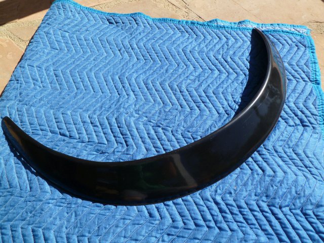

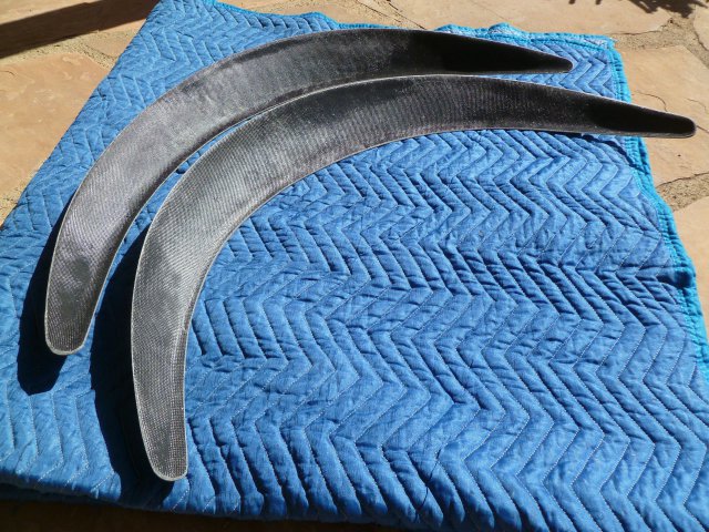

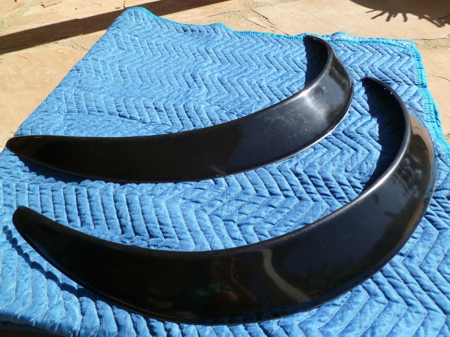

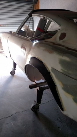

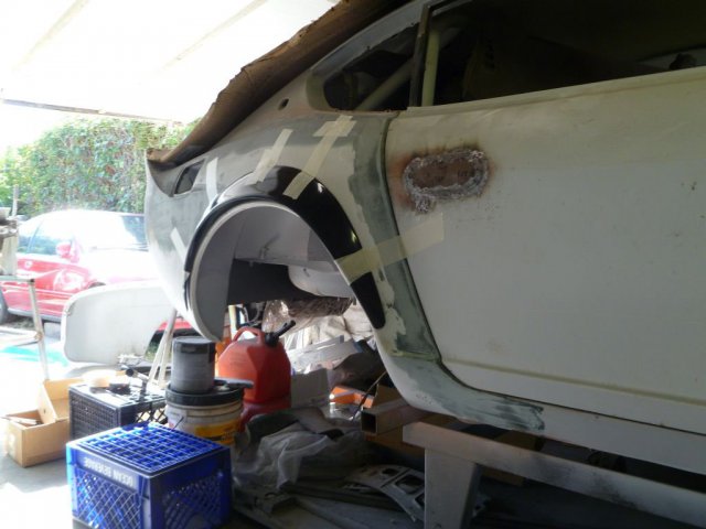

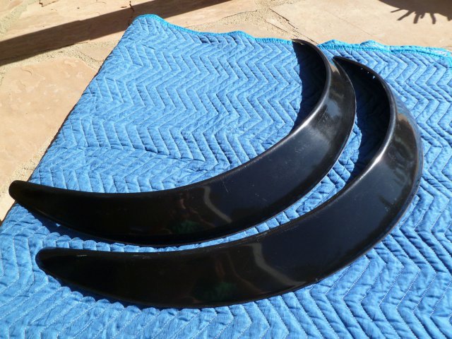

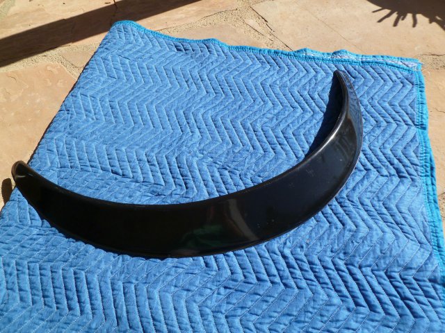

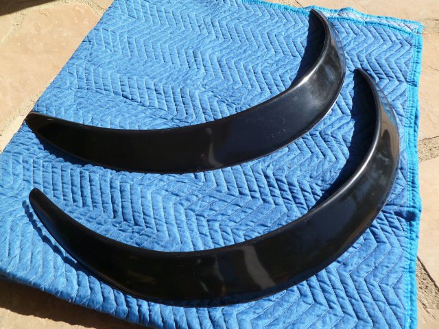

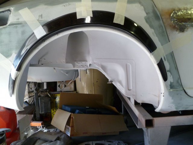

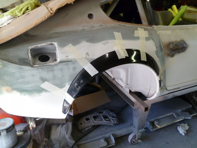

Nelsonian Posted October 24, 2018 Share Posted October 24, 2018 (edited) I have a set of unused rear smooth style ZG flares that I bought from (MSA) Motor Sport Auto and never ended up using them or plan on using them as I went a completely different route altogether. These are ultimately intended for bonding onto the stock rear quarter panels, but I imagine could be adhered instead for a type of temporary hold. The pictures included showing them taped on my car are actually resting on an existing wide body rear quarter panel from Ztrix.com, ( "Subtle Z" ) which are 1.5" width over stock. Edited October 24, 2018 by Nelsonian Quote Link to comment Share on other sites More sharing options...

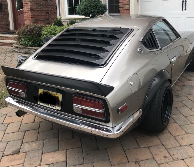

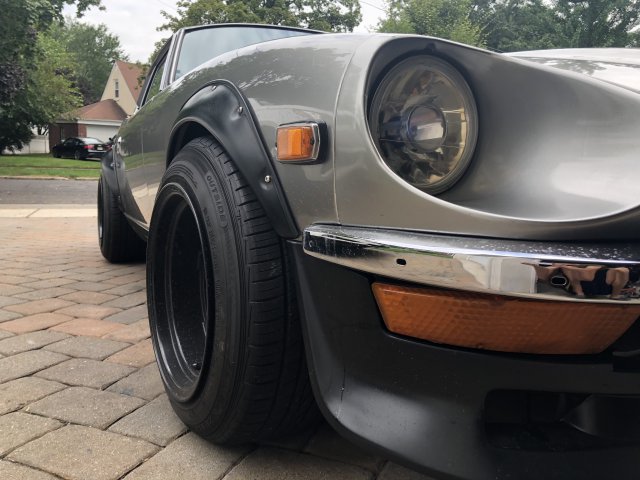

captainkim Posted October 24, 2018 Author Share Posted October 24, 2018 thanks for the responses. I have a 240z with the flares on them but I hate having to had to drill into the fenders....The next Z im contemplating on leaving it on without but will miss the wider tires and look. I guess you cant have the best of both worlds. Quote Link to comment Share on other sites More sharing options...
jhm Posted October 24, 2018 Share Posted October 24, 2018 Nice-looking 240. I suppose you *could* mount standard flares right on the lower edge of the fenders with glue or double-sided tape, which might give you the look you're seeking. You would then have to either space the wheels out (with spacers/wheel adapters), in order to "fill" the flare -- otherwise it would look really silly to have flares sticking way out but wheels and tires buried deep inside. You would have to be extremely careful to measure and test fit everything to ensure that the wider stance does not result in interference between the tires and the fender sheetmetal. Suspension travel would likely be limited, otherwise you're looking at a major interference issue. All in all, a lot of work for pure aesthetics IMHO....and possibly to the detriment of functionality. It actually looks like this is how your current flares are mounted, from looking at your pictures (except they are screwed in for mounting, vs tape or glue). If those tires were wider, I'm sure there would be interference issues. Drilling holes for the mounting hardware is actually very minimally invasive. The real "damage" is done when cutting the sheetmetal to enable wheel movement and suspension travel, especially in the rear because you're cutting the unibody and having to reweld after cutting. Probably not the answers you wanted..... Quote Link to comment Share on other sites More sharing options...
