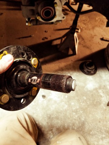

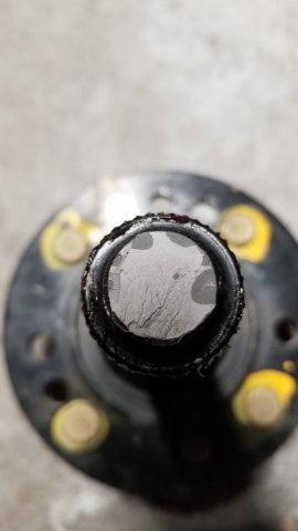

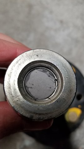

20181117_175654.thumb.jpg.9c99db4de9785254212c165864cb5cba.jpgThis just happened  to me today installing my WHP 39 spline chromoly stub axles (ZXT companion flange). Installed at 180lb/ft, then gradually tightened until 750g breakaway weight at the hub per manual (maybe another 1/3 turn). And NOT using an impact. 3 hours later I hear POW! and find the flange and nut on the ground. Fortunately the car is sans drivetrain right now and on jack stands ie 0 miles, no burnouts,  launches, etc.
I emailed WHP but its the weekend so, waiting for monday. Wanted to add to the thread though in case there is a common vendor issue.
Very odd coloration at the fracture...
Edited by SH4DY
Share this post
Mike @ Whitehead got back to me this morning ( Sunday- that's pretty solid customer service) and said they had a batch of 27 spline axles that had been annealed incorrectly and were all recalled. Mine was the first reported 39 spline failure but he sent them the pictures I took to see if it is a similar defect. If so, they'll probably replace them.

Just to update: WHP advised me to try to torque the other stub axle per FSM specs and see if it would fail as well. And it did. Except I realized that my wrench only goes up to 150 lbs/ft so the initial failure was also at less torque than I thought. Anyway, this one didn't fail as spectacularly: I torqued to 150, then tried the hub resistance in 1/4 turn increments. On the 3rd or 4th try, the resistance fell of significantly and I thought the threads had stripped. Nope, it just split about half way into the nut so it was still partially threaded.
They are supposed to be making a new batch and shipping me some.

Yes there was a batch that wasn't annealed properly.  Somehow they slipped thru their QC.  Common problem is what you see here too hard the end just snaps off.  If you have a set you would like to have checked please send them back to me.  I will take care of it for you.  Sorry for the inconvenience.
FYI the manufacture just upped their price on each part by $50.00.  So that puts my cost at $750.00 plus shipping almost what they sell them for. Don't forget I need to buy 10 parts at a time.
Thanks  Joe
