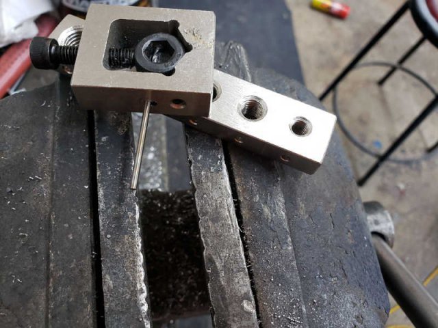

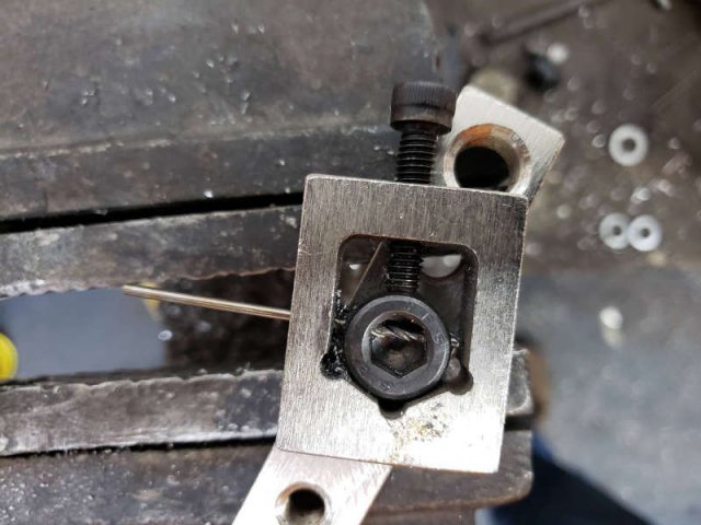

JMortensen Posted August 21, 2019 Author Share Posted August 21, 2019 I ended up just drilling a hole in the tool so that I can drill right through the middle of the bolt. It was going through at an angle. Drilled 5 more bolts without breaking the bit. Two more to go, just ran out of time. Quote Link to comment Share on other sites More sharing options...
Neverdone Posted August 21, 2019 Share Posted August 21, 2019 Got a link to the tool? Also, any pictures of how you modified it? Quote Link to comment Share on other sites More sharing options...
JMortensen Posted August 21, 2019 Author Share Posted August 21, 2019 Tool: https://www.amazon.com/gp/product/B074J83Q2V/ref=ppx_yo_dt_b_asin_title_o01_s00?ie=UTF8&psc=1 There is a larger hole on one side and a smaller on the other side of the piece that locks onto the head of the bolt. I'm using .031 safety wire, so I used the smaller side. When drilling through the round head, it barely hit the bolt at all, so I just drilled a hole farther over. It's a cheap tool and really there are super hard drill bushings that you can buy that would make this thing a lot more durable but probably increase the price a lot. My self drilled hole has already wallowed out quite a bit, but it will work for 8 bolts. If I was doing this a lot I'd buy a better tool. I'll take a pic when I get out to the shop today. Quote Link to comment Share on other sites More sharing options...
JMortensen Posted August 21, 2019 Author Share Posted August 21, 2019 I also figured out that if I set up the drill jig in a way that the drill bit hit the inside of the Allen head flat, that was better than hitting an angled surface. You can see how oblonged the hole in the tool is, but as you said earlier, placement doesn't really matter, just need to get a hole in the bolt for the wire to pass through. Quote Link to comment Share on other sites More sharing options...

JMortensen Posted August 21, 2019 Author Share Posted August 21, 2019 I got through all of them with 3 Harbor Freight cobalt bits. Broke the first 2 bits on the first two bolts. Once I changed the angle I was drilling at, no problems at all. I agree cobalt is the way to go though. I used to get Harbor Freight gift cards as credit card rewards so I have a ton of their tools and have tried all their bits. They all suck, except the cobalt ones, which are pretty amazingly good IME. Quote Link to comment Share on other sites More sharing options...
