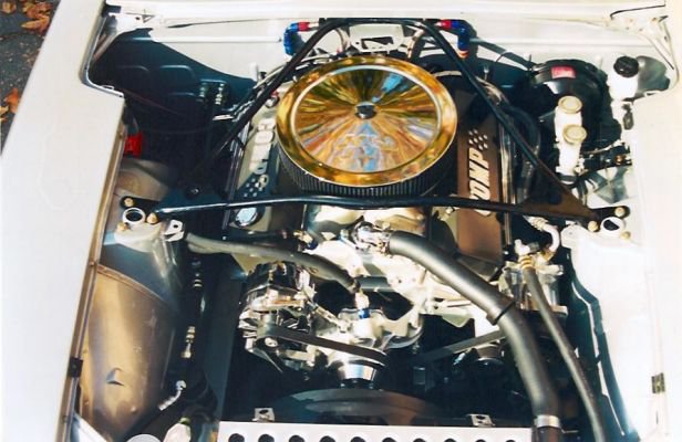

A front bar that just goes across from tower to tower does not do that much compared to the triangulated bars that tie to the fire wall. If you have a stiff suspension and sticky tires or your are giong to autox the car I would only go with the triangulated type. The PDK goes one step farther and mimics the welded tubing that racers use, that would be my choice.
I like the pdk front but it seems like everytime you need to work in the engine bay you will have to remove at least parts of it to be able to work on the car, I do like the triangle set-up that http://www.racetep.com has but I am not sure it will work with my V8 set up, I am thinking about getting someone local to just make me one so it will have some bends in it to work with my set-up
Actually it's the TEP one you have to remove all the time. You have to pull the whole TEP to adjust the valves. The center link of the PDK comes out, so unless you were working on the clutch or brake master the PDK is pretty much out of the way.
EDIT--I just realized you have a V8. I still can't think of anything that you'd need to do on a V8 that would require removal of anything other than the main crossbar.
