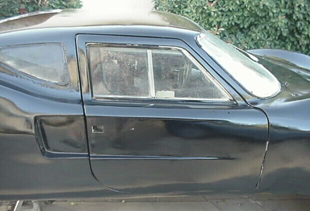

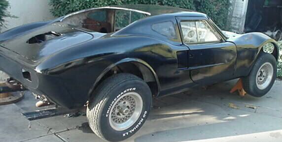

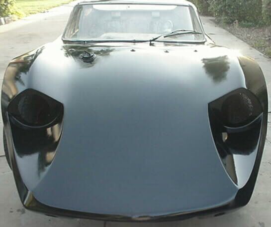

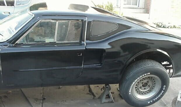

primer&rust Posted May 30, 2007 Share Posted May 30, 2007 Here are some picture of my kit car in the process on the fourth coat of black gloss Rustoleum paint. Wanted to paint it with rollers before I tried it on my Z. Thought you all might want to see some picture in progress. Quote Link to comment Share on other sites More sharing options...

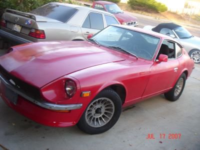

ORANGEZ Posted July 21, 2007 Share Posted July 21, 2007 ok so i paint the entire car with 4 coats so far but it looks like i got drip marks and when i look at the paint at certain angles i can see it drips of paint running down through the 4 layers....paint looks nice other than these certain areas..so the question is should i wetsand it and put more layers or just continue to add layer and sand at the end???.. Quote Link to comment Share on other sites More sharing options...
OlderThanMe Posted July 21, 2007 Share Posted July 21, 2007 Wetsand until it is flat then add some layers. You may wear through a layer getting it flat but that is fine. Just add more paint on top. You can give the drip area a quick polish to see if you got it flat enough. I just use aluminum polish to do a quick check... Just sand it back down before you go back over it. OTM Quote Link to comment Share on other sites More sharing options...
