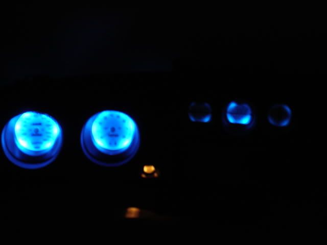

LLave Posted September 4, 2006 Share Posted September 4, 2006 I am planning on upgrading my gauges while my dash is out, but funds are sort of low so I was thinking about an inexpensive way to improve the appearance of the stock gauges. (although it does nothing for their accuracy of course) I tried to get the shutter speed to accurately show what they look like, I had it cranked to get the stock lights to show up but then had to turn it down to keep the leds from looking like a super nova. Anyway what do you think? OLD NEW Quote Link to comment Share on other sites More sharing options...

LLave Posted September 4, 2006 Author Share Posted September 4, 2006 wow, http://www.superbrightleds.com sells some really neat products. I think I will order some white LED's and some diffused 360deg blue LED's and do some more experimenting. Some more details on the the gauge lights pictured. The green is of course the stock lighting For the blue, I first removed the green lens then installed 4 super bright blue LED's (2600mcd, 468nm, 30deg) 2 on the left and 2 on the right as evenly as I could get them. I used 4 LED's just to keep the light as even as possible on the face of the gauge. I used a little dab of some good clear silicone to hold them in, which seems more then adequate. I then carefully routed the wires where they would be clear of the gauge's mechanical parts and out the original light bulb hole. This worked ok but when I do it for real I may drill holes and install snap in led holders. Also to help the light reflect on to the face I painted the back side of the front of the gauge with a quick shot of krylon gloss white. But I did that before any photos were taken so the picture of the stock green is after paint. Another thing to note is I am powering the gauge from a 12vdc power supply so it would be like the dimmer switch is on full blast. I was also toying with the idea of installing the LED's in sets of red, green, blue. Then wiring each color to its own dimmer switch. Then by adjusting each dimmer switch I could effectively change the gauge light color... maybe... kind of like what they have going on in the new mustang. But that is 3 times the parts and wiring. Quote Link to comment Share on other sites More sharing options...

Sparky Posted September 5, 2006 Share Posted September 5, 2006 Sparky' date=' Curious, did you play with the dimmer at all? Did it reduce the harshness any? TIA[/quote'] I did not install a dimmer when I rewired my car, but I dont think that would help. One of the problems I encountered when using the bulb replacement LEDs is that there are dark spots in the gauges, especially in the speedo and tach. if i'm understanding LLave correctly he did not place the LEDs in the stock locations, but rather wired in several small ones around the front of the gauge...LLave correct me if im wrong. I think that that would be the way to do it in conjunction with a dimmer in order to keep the harshness down and prevent dark/blind spots in the gauges. wow' date=' [url']http://www.superbrightleds.com[/url] sells some really neat products.I think I will order some white LED's and some diffused 360deg blue LED's and do some more experimenting. They do have some really cool stuff, fast shipping too. I bought one of the 3 LED pre assembled units in red and mounted it behind my rear view mirror in order to replicate the dash/console/shifter lighting found on the newer BMWs...it creates a nice low key red glow on the shifter, boost controller and combo switch. some might call that ricey but it really helps you see certain switches and knobs at night without having to turn on the interior lamp. Nice clean install on those gauges, that looks really good. Quote Link to comment Share on other sites More sharing options...
LLave Posted September 5, 2006 Author Share Posted September 5, 2006 if i'm understanding LLave correctly he did not place the LEDs in the stock locations, but rather wired in several small ones around the front of the gauge...LLave correct me if im wrong. Exactly, I placed 4 single LED's around the gauge facing the front so they would reflect onto the face of the gauge evenly. Quote Link to comment Share on other sites More sharing options...
