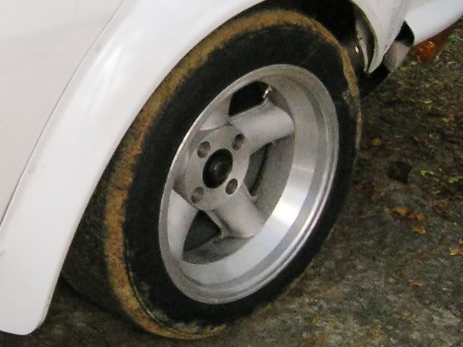

Ledphoot Posted December 26, 2006 Share Posted December 26, 2006 I dont know what I'm gonna do for wheels either. I want to dragrace weekends so I cant use adapters or deep spacers because of track rules. I want to run 15 or 16" wheels. The more I hunt for something reasonable ( and for me that means CHEAP!) the more I think I'm going to try to do the cheapest swap possible to get 5 lug hubs. Z's are new to me so I'm as lost as anyone.. I agree that wheels are really the last major thing you want to do with a project so that the suspension and brakes are already what you want... Quote Link to comment Share on other sites More sharing options...

Ledphoot Posted December 27, 2006 Share Posted December 27, 2006 I just want a couple of old school slots 15x8 or 15x9 or 10 4 lug that I can use with no adapters and some drag radials. I'll keep 14x6 slots in the front if thats all I can find, and a mini spare. I'll be doing my "giddy up" in a straight line.. Quote Link to comment Share on other sites More sharing options...
