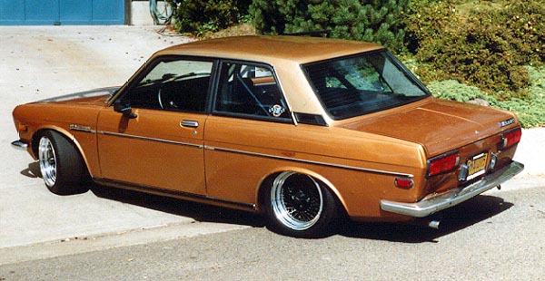

Many, many thanks to all of you guys that have chimed in. I would love to have the car cleaned up, rust fixed, suspension done and primered and sitting on some sweet old skool Enkeis...I love this look!:
