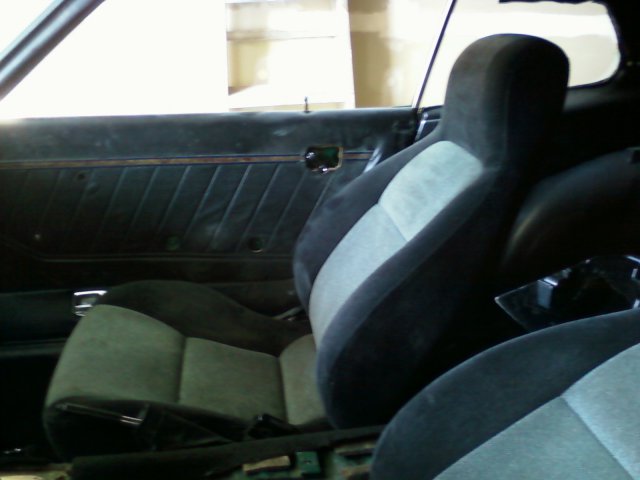

chrismiller5157 Posted July 23, 2009 Share Posted July 23, 2009 i was told that if i was to put S2000 seat's in my S130 i would have to weld them in.............sounds stupid i think. so did u have to weld them in...... i feel stupied for posting this question but must know. S2000 seats. They sit lower than the Eclipse seats that were in it when I got the car. Now my head doesn't rub the ceiling. Link to comment Share on other sites More sharing options...
Diablo Posted July 29, 2009 Share Posted July 29, 2009 i was told that if i was to put S2000 seat's in my S130 i would have to weld them in.............sounds stupid i think. so did u have to weld them in...... i feel stupied for posting this question but must know. I put these seats in my 74 260 and they do seem to sit high, I might have to cut off the stock brackets below the seats and weld them in, that should take an inch or so off. Link to comment Share on other sites More sharing options...
chrism Posted July 30, 2009 Share Posted July 30, 2009 No, I made some new brackets using flat stock steel 3/16" thick and 1.5 " wide. There are 4 pcs of flat stock that I used. The first two run front to back and line up over the holes in the floor. Bolt them to the floor. The 2nd set run left to right. On the driver side, I had to put the flat stock on top of the left bracket closest to the door and under the bracket next to the trans tunnel. That got the seat to sit level and lower. Do the same with the passenger side. The 2nd set of flat stock mounts will also hang past the first set of flat stock mounts. Then you put the seat in and get it lined up. Mark the holes and then drill them out so you can bolt the seat in. The idea is that the first set will bolt to the existing holes in the floor and the 2nd set will bolt to the holes in the seat. Hope this helps Link to comment Share on other sites More sharing options...

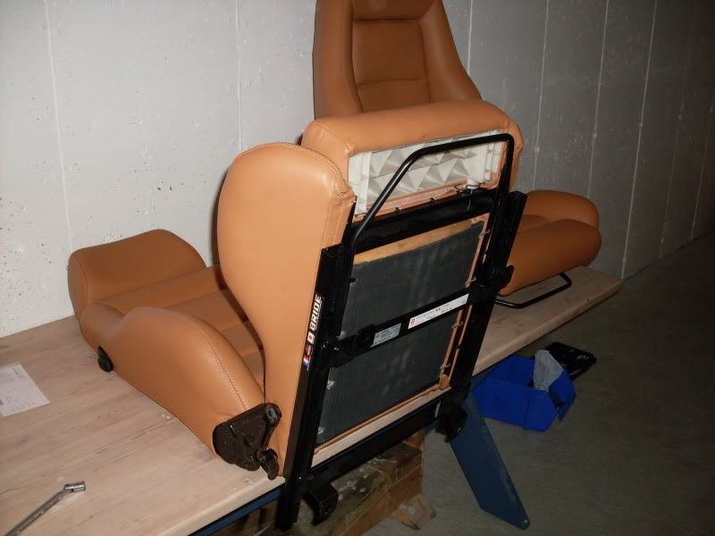

ROVdriver Posted October 6, 2009 Share Posted October 6, 2009 Here is my Recaro LS seats in 72 240z. They are originally mounted in Audi RS2 Link to comment Share on other sites More sharing options...
icapture Posted October 6, 2009 Share Posted October 6, 2009 Here is my Recaro LS seats in 72 240z. They are originally mounted in Audi RS2 LOVE those seats. I am partial to installing modern looking bucket seats in a 197_ car. For some reason they just dont look right in my opinion. Now, race seats in a race 240Z is a different story. But for a daily driver I dont think they look right. I WANT your seats! Digging that suede center console / dash too man. We have similar tastes. Oh, and I love Norsk girls too ; ) Link to comment Share on other sites More sharing options...
310z Posted October 7, 2009 Share Posted October 7, 2009 ROVdriver, Wow that is amazing looking. The colors go togather. My hat is off to you and who ever did the work. Link to comment Share on other sites More sharing options...

T S30 H Posted October 11, 2009 Share Posted October 11, 2009 S2000 seats. They sit lower than the Eclipse seats that were in it when I got the car. Now my head doesn't rub the ceiling. This makes me want to rip out my seats from my s2000 and put it in the z. BTW, what type of carpet kit is that? I noticed your wheel housing are also covered in carpet along with the tranny tunnel. Where did you get that kit? or is it custom? Link to comment Share on other sites More sharing options...
T S30 H Posted October 11, 2009 Share Posted October 11, 2009 Here is my Recaro LS seats in 72 240z. They are originally mounted in Audi RS2 Can I ask for that part number on the Bride Rails? Where did you get those from? Do they mount to stock holes or did you have to fab them into the frame? Link to comment Share on other sites More sharing options...
chrism Posted October 11, 2009 Share Posted October 11, 2009 Carpet is custom. Link to comment Share on other sites More sharing options...
240zBoy Posted October 12, 2009 Share Posted October 12, 2009 ROVDriver- That is by far my favorite Z-interior I have seen. Love the dash and console suede covers you have to. 6/5:flamedevi Link to comment Share on other sites More sharing options...
