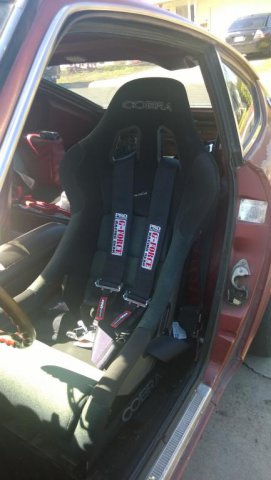

chrismiller5157 Posted February 26, 2011 Share Posted February 26, 2011 The bride seats look amazing! And I'm glad your having success with them. Although, I have a few friends that's have those exact seats and they are not happy with them at all. They all have had ripping issues and the seats just show wearing with in a years time. Al I'm saying is you may want to consider a vinal or leather bride seat, if your going with bride at all. Racaro is the only seat that I personaly will trust to spend money on if its going to be cloth or Suade. I'm going to be using Cobra 40th anniversary carbon seats(leather) Well, I got the seats in and had some brackets made for them. I installed them last night and it looks like they fit perfectly. The only problem is that the top left bolster is hit BARELY bit the door. I have the interior door panels off right now because I'm doing some work and they don't touch, but the space between them is seriously like under 2 CM. but, there is enough space on the other side that if you made your own brackets you could move the seat over to the left just a tad and be perfect. I can post up pics if needed, but that's not going to be for a few days. Link to comment Share on other sites More sharing options...

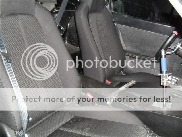

Ducer Posted January 11, 2012 Share Posted January 11, 2012 (edited) Hey yallllllllllllllllll... Add to the List 2008 Mazda MX5 Miata Seats annnnnnnnd seat belt conversion~ I found these Brand new seats on Craigslist couple of weeks ago with seat belts for $100 bucks! Freaking brand new and the owner had stripped his Miata to build a race car in which he had aftermarket seats and these weren't even used. So killer deal and I was on Craigslist looking for older 90's miata seats but these were a killer steal. As I am driving to pick them up, about 1 hour drive which was worth it, I kept thinking please please be flat bottom mounted please........ And they are! The front part of the seats didn't need any modification except drilling 2 new holes on the S30 front bracket which each seat stud was 13" apart and datsun seats were like 11". The Rear of the seat just needed a flat 1.5" wide flat channel bar to offset the width about 1/2" on each side and about 1.5" back, and that's about it. So I even used the 2008 Miata seat belts, which was freaking awesome because the 14 or 17mm bolt on the C pillar of the S30 was the same thread! and freaking bolted on. I just made a custom bracket for the seat belts. Miatas were convertibles so the seat belt assembly had to sit where I put it due to the length of the retraction. I tried putting the seat belts on the floor as stock ones, but it too way too much tension taken and the unit kept wanting to fully retract, so I built my own cage for it. Migged it up, and bolted two 10mm in the middle of the lid compartments, and 3 (M8 bolts and nuts) drilled through the rear strut tower support bar. LMK what you think, it's freaking awesome upgrade. The seats are perfect. No rubbing, Slides fully back and forward. Miata seat has tilt pump ratcheting handle which moves the seat cushion up and down, so awesome. Height is almost as low as stock s30 seats, these will fit 6" to 6'2", Im 5'7" so heck, it's superb. Edited January 11, 2012 by Ducer Link to comment Share on other sites More sharing options...

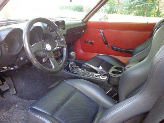

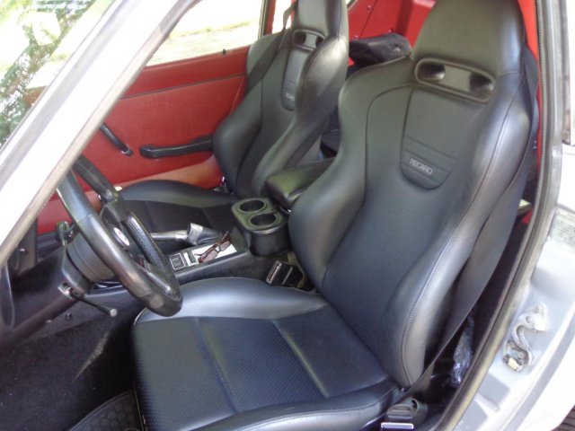

PLATA Posted July 10, 2013 Share Posted July 10, 2013 (edited) Man, what an old but valid thread >>>>>>>>> my leather RECARO seats , they have that magic feel / scent that invites for spirited driving Edited July 10, 2013 by PLATA 1 Link to comment Share on other sites More sharing options...
Rob L Posted March 23, 2014 Share Posted March 23, 2014 ^^ what recaros are those ? Link to comment Share on other sites More sharing options...
mattster03 Posted May 10, 2014 Share Posted May 10, 2014 S2000 seats. They sit lower than the Eclipse seats that were in it when I got the car. Now my head doesn't rub the ceiling. I was wondering if anyone had done S2K seats... they look as good as I hoped in a Z Link to comment Share on other sites More sharing options...
Wedge Posted May 17, 2014 Share Posted May 17, 2014 Man, what an old but valid thread >>>>>>>>> DSC00697.JPGDSC00692.JPG my leather RECARO seats , they have that magic feel / scent that invites for spirited driving ^^ what recaros are those ? Looks like Evo 8 recaros. Link to comment Share on other sites More sharing options...
Nelsonian Posted May 17, 2014 Share Posted May 17, 2014 There from a Lancer Evo 9 from 05' - 08'. The Evo 8 had a blue cloth middle insert only. Link to comment Share on other sites More sharing options...
