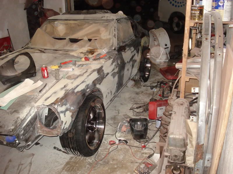

jeffer949 Posted July 12, 2008 Share Posted July 12, 2008 Got them on and mounted!!!! here is some pics and yes i know the rear is on the wrong side. just threw them on for some pics they are allready off the car. The car is in rough shape right now give me a few weeks and she will be pretty again. Quote Link to comment Share on other sites More sharing options...

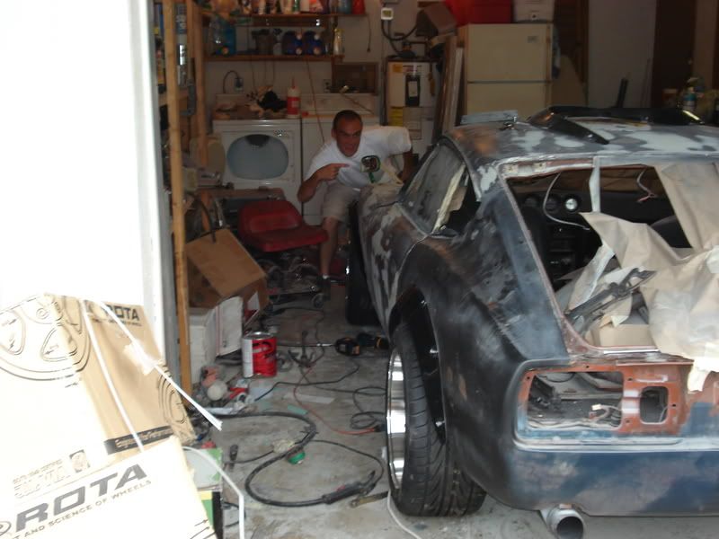

jeffer949 Posted July 16, 2008 Share Posted July 16, 2008 Here are some pics with the zg's mounted also. there is no way to get the rears on with out flaring. But i do believe it might be possible to get the fronts. I also believe you might be able to put the 9inch with -13 offset in the rear and have it fit. but i believe both would require alot of lip rolling and fender stretching. Here we have Grassroots motorsports mag's employee Greg Vogth actin a fool. And i wont be in daytona next year. Im moving at the end of the month. hence the rush to get my car painted. I actually live in ormond beach not daytona but people dont know where ormond is. Quote Link to comment Share on other sites More sharing options...
jeffer949 Posted July 16, 2008 Share Posted July 16, 2008 275/40-17 in back and 255/40-17 in the front. i think they would but i dont see the need. I might actually space the front out a bit as my clearance to the spring perch is probably around or under an 1/8th of an inch. Just a tad close for my liking. Ill have to do it later though. Quote Link to comment Share on other sites More sharing options...
