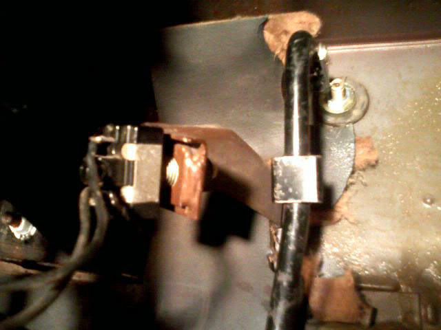

Mysterious gas pedal button
no my car isnt auto but who knows it could have been. not sure how to post a pic but here it goes:
Ok this is weird... i know what it is now but at first glance i see a birdseye view of a dark hair dark skin kid with a white shirt on standing in the grass.
Left side of the pic about 2 inches up.... see it???? or is it just me????
Another vote for WOT switch for an auto car. Looks liek your car has been converted to a stick. Future location for the NOS switch. Also like Ron said, remove your pedal and bend that rod over an inch in a vise so the cable lines up correctly.

Looks like automatic kickdown.
It also looks like your Lokar throttle cable is waiting for an opportunity to fail. That kink where it passes through the firewall will eventually break.
My '71 had an automatic and has the same square tab on the throttle rod and a very similar mount on the inside firewall. No switch. I'm sure it is a kick down switch.
