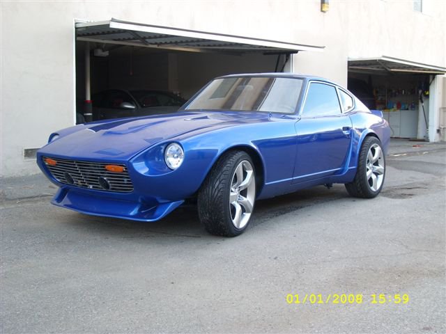

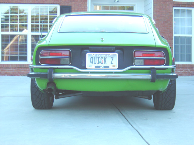

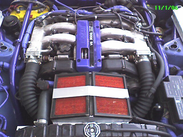

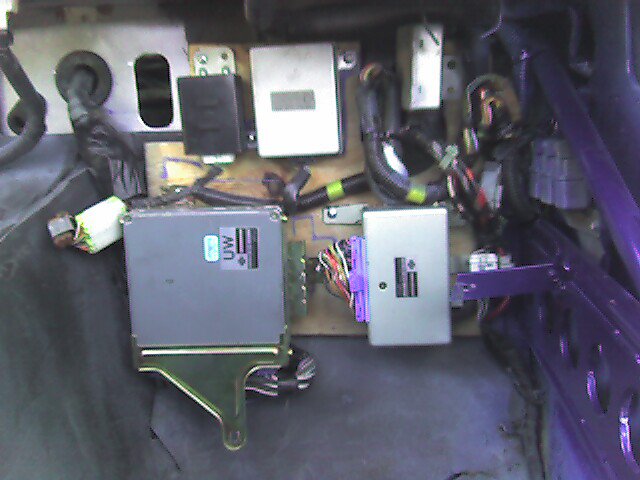

new40z Posted January 27, 2008 Share Posted January 27, 2008 I posted this in the s30 section but Mario suggested it would be better here. (Thanks Mario!) Anyway this is my project 240z it's on the road now and runs great, I swapped the engine, trans,dash,seats,suspention, antilock brakes, taillights, a/c from my crashed 93 convertible. Unfortunantly it's @ my home in Ca. and I'm stuck working in Iowa for awhile. Hope you like the pic's, Please let me know what you think? John Papasergia (new40z) Quote Link to comment Share on other sites More sharing options...
mario_82_ZXT Posted January 27, 2008 Share Posted January 27, 2008 Cool man looks great! What I meant was the s30 section under tech not projects. This place gets more traffic anyways Sweet Z! Mario Quote Link to comment Share on other sites More sharing options...
rturbo 930 Posted January 27, 2008 Share Posted January 27, 2008 looks good. i especially like what you did with the grill. did you just combine two 240z grills? do the two cut outs have a purpose? only thing i dont like about the car is the doglegs. looks odd to me, but to each their own. otherwise, the car looks very clean. link to grill pic: Quote Link to comment Share on other sites More sharing options...
datsun40146 Posted January 27, 2008 Share Posted January 27, 2008 That is amazing work! Kudos to you for just being an artist! Quote Link to comment Share on other sites More sharing options...
new40z Posted January 27, 2008 Author Share Posted January 27, 2008 The grill is made from scratch and I have some driving lights that go in the two round openings, hopefully I'll install them next trip home. As for the doglegs? I think you mean the flares behind the doors? I made the flares from replacement 1/4 panels (all steel ) If I was starting over I might consider blending them further forward into the doors. I guess There's a lot of things I might have done differently if I had done more research. Glad you like it. Heres a better pic of the front Quote Link to comment Share on other sites More sharing options...

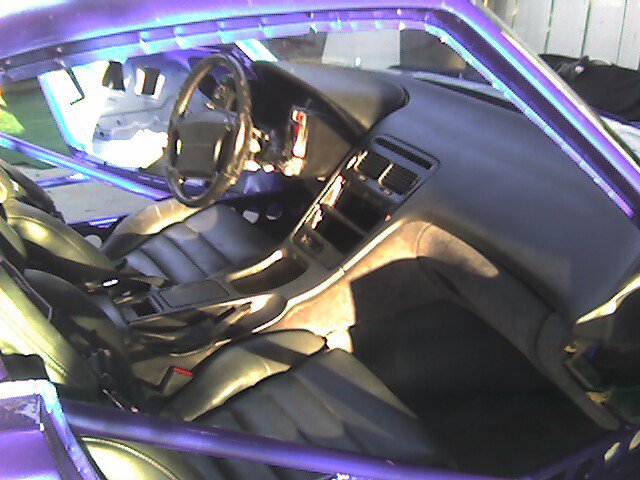

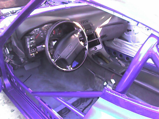

CamH Posted January 27, 2008 Share Posted January 27, 2008 I LOVE the dash swap. I definitely miss the interior of my 300ZX. Do you have pics from when you were doing this swap? I'd love to get more info on the dash swap for sure. Quote Link to comment Share on other sites More sharing options...
mikeatrpi Posted January 27, 2008 Share Posted January 27, 2008 It looks fantastic! You do excellent work! Thanks for sharing Quote Link to comment Share on other sites More sharing options...

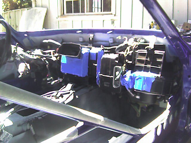

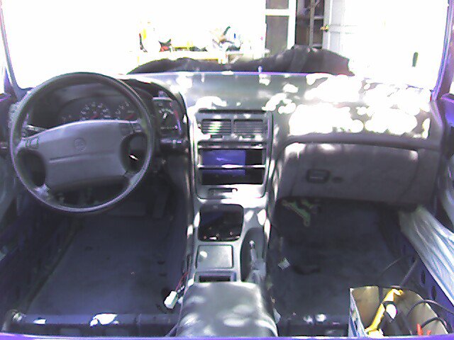

new40z Posted January 27, 2008 Author Share Posted January 27, 2008 The dash swap was pretty straight forward, keep in mind I built my own steering column because I wanted to use all the controls from the z32 and the z32 power steering, (this was a bit more involved---custom engine x-member reversing the steering links, custom tie rod ends.....) I started with the center console (it has the same bolt up pattern) and worked my way forward, had to relocate the e-brake backwards a few inches then I trimed the dash to fit the arc of the wind shield. Pull the vinly back and cut with a jig saw then stretch the vinly back and glue it down underneath. I welded in multiple mounting tabs alined the z32 a/c center duct and screwed it into place. Easy right? Impretty happy with it, I still have to complete the interior. PS its pretty darn tight inside the z32 seats are really big. Here's some pic's John Papasergia Quote Link to comment Share on other sites More sharing options...

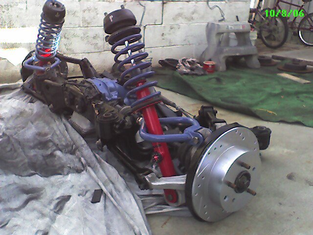

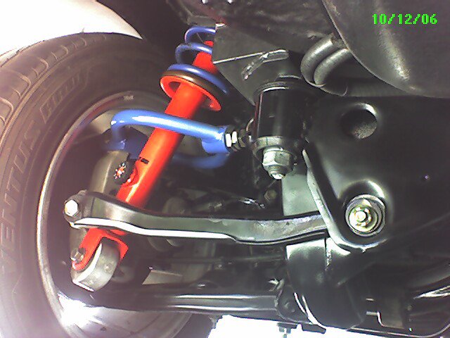

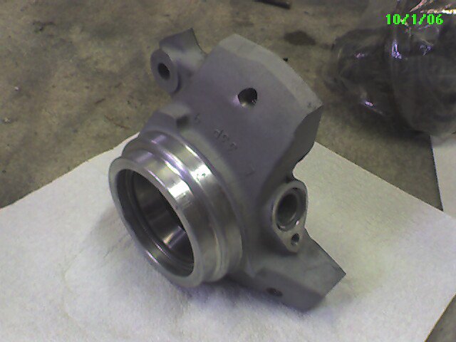

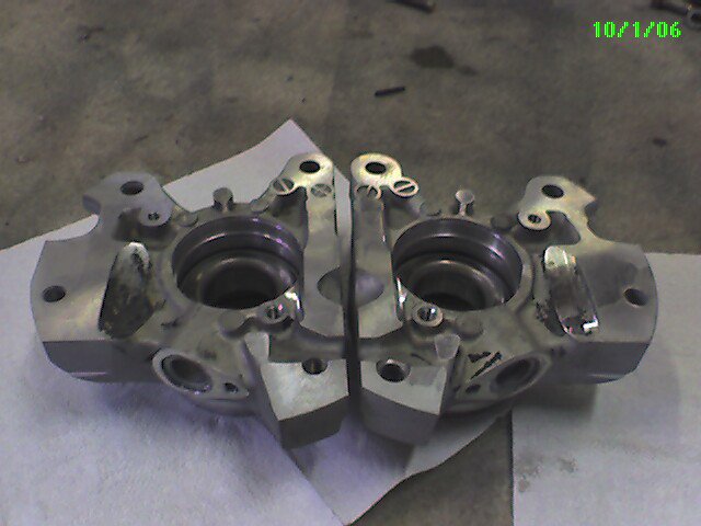

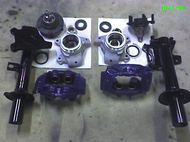

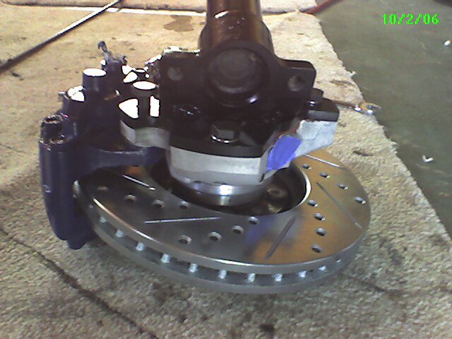

new40z Posted January 27, 2008 Author Share Posted January 27, 2008 Here's some pics of my front suspension setup . I machined the knuckles from the spindles of the 93 parts so I could mount them to 71 struts and be able to use the antilock system and have the bigger brakes. Maybe a bit unconventional but it was free since I had the parts and ran a machine shop. Oh, It stops on a dime. Quote Link to comment Share on other sites More sharing options...
