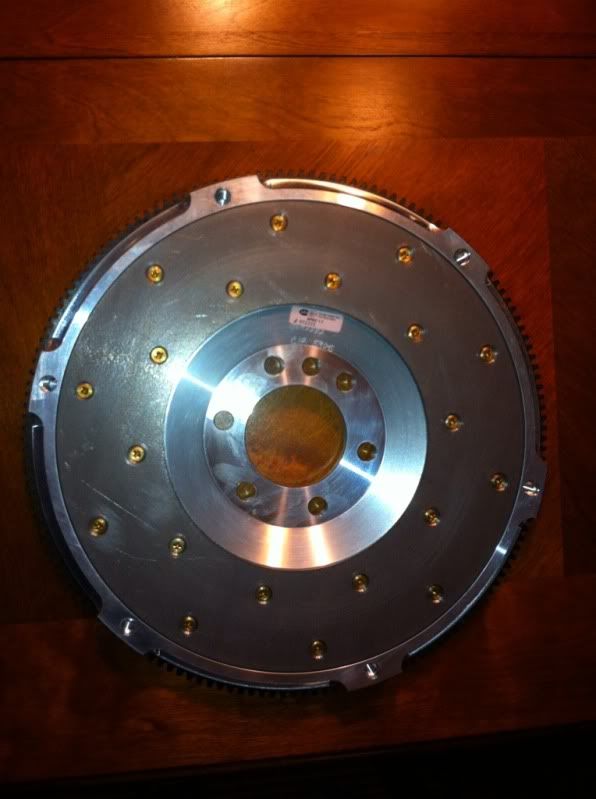

Mikelly Posted January 14, 2012 Author Share Posted January 14, 2012 This came in the mail for me... Gotta order the battery, and the wheels. Mike Quote Link to comment Share on other sites More sharing options...

Mikelly Posted January 21, 2012 Author Share Posted January 21, 2012 (edited) We're going to weigh everything to confirm this, but it looks like we're going to be able to reduce our total weight on the vehicle by possibly 90 pounds. Swapping from carburetor supplied fuel system to the FAST efi was a net push, due in no small part to the complex nature of the fuel system we were using. Now I'm not going to use two pumps, the surge tank, and other related parts. Instead, we have one, tiny pump and one tiny regulator. We did add 8 injectors, some wiring and an ecu, so we're thinking that it's a net of maybe adding 5 pounds. The front wheel/tire combo we're going with is a net savings of 12 pounds per corner. The rear wheel/tire combo we're going with is a net savings of about 10 pounds per corner. The fidanza flywheel is 10 pounds. the information in my build book on the CAT flywheel shows it measured by the builder at 32.3 pounds, so that's another 22 pounds shaved off. The Braille Battery is saving me 23 pounds over the 38 pound Optima Redtop. So far that combo should be good for 89-90 pounds. I hope we can get this car into sub-2600 pounds. When we corner balanced it before Watkins Glen, she weighed in at 2709 without driver. So we're atleast on the right track now... Oh and the total bill came due for the CCws... Getting them in the sizes I wanted with black anodizing on the outer shell and the center ran more than I expected. Total was $3275 shipped for the LM20s. Mike Edited January 21, 2012 by Mikelly Quote Link to comment Share on other sites More sharing options...
