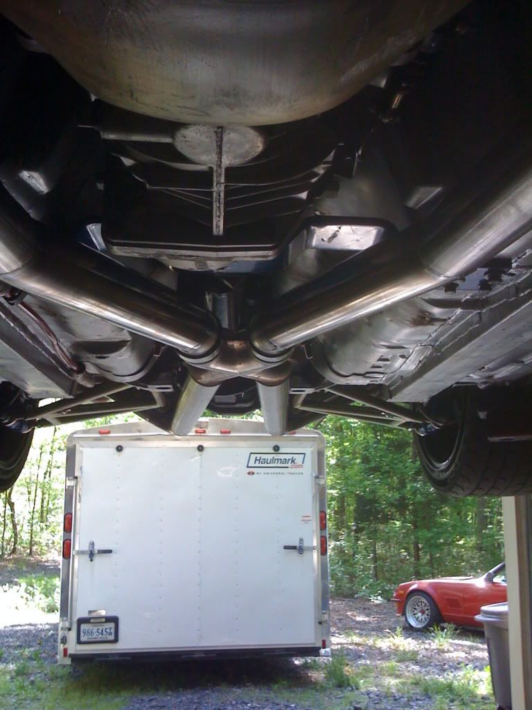

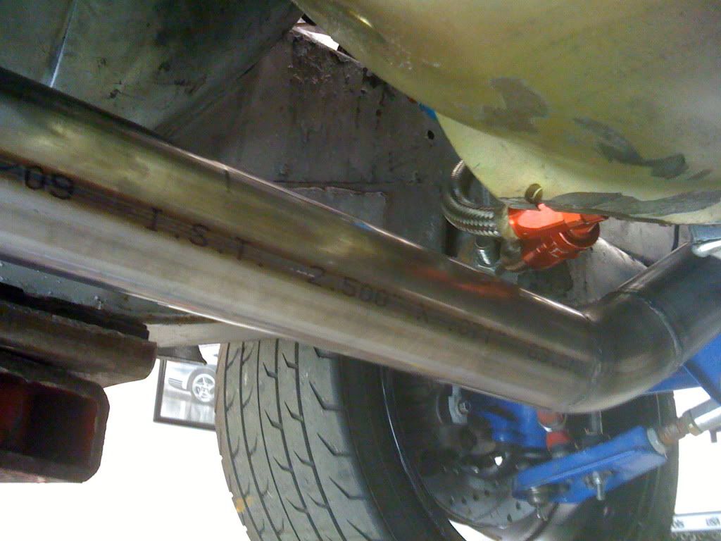

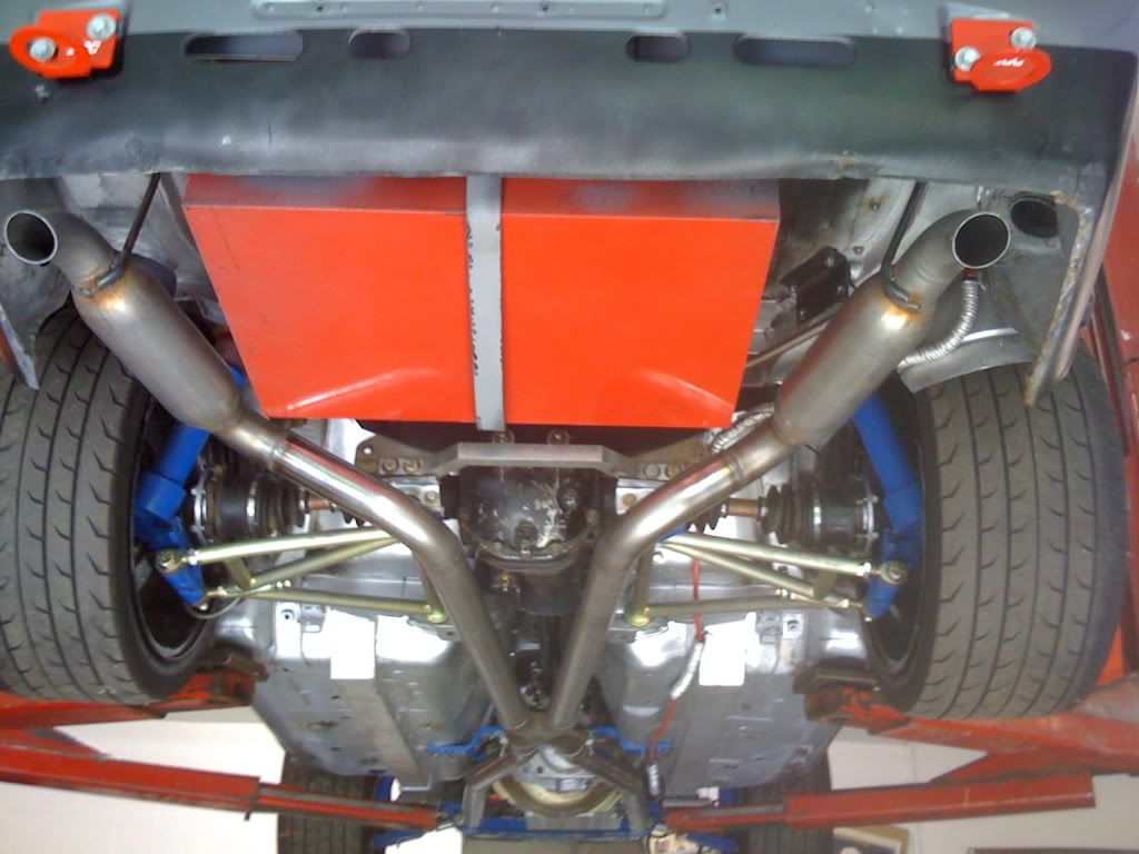

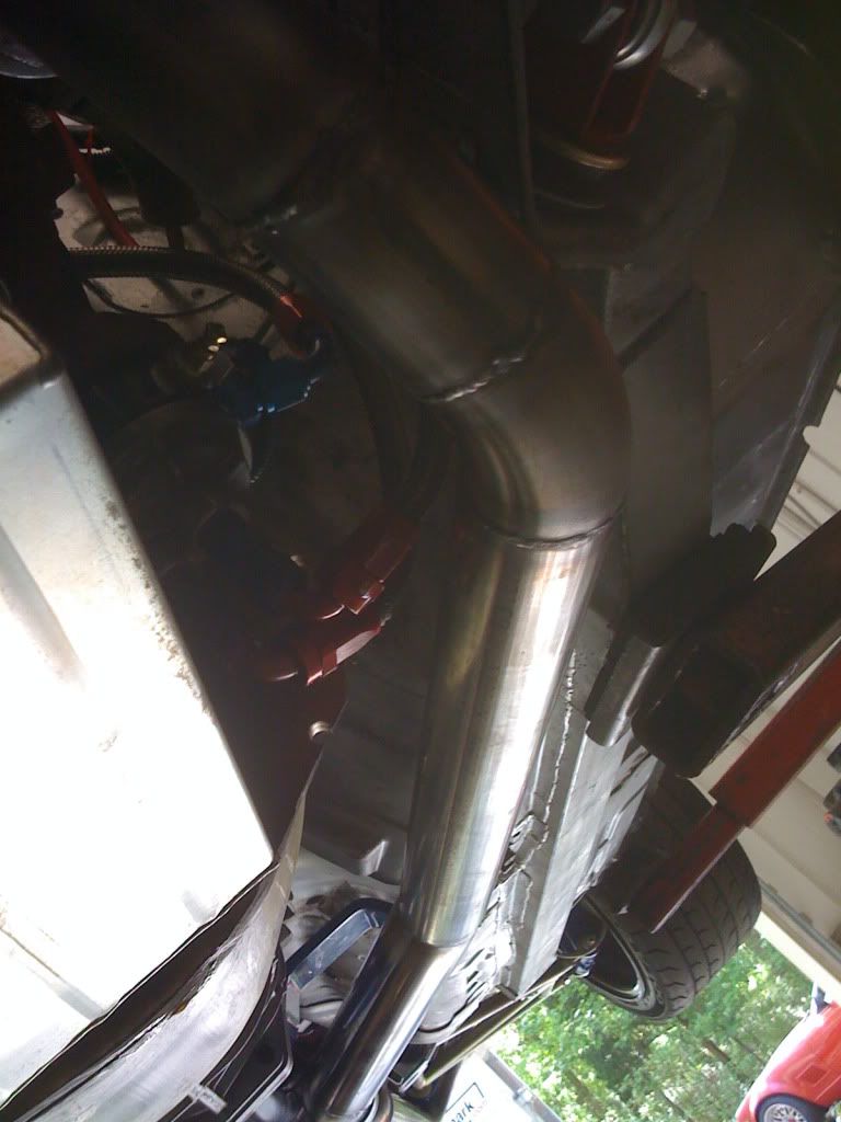

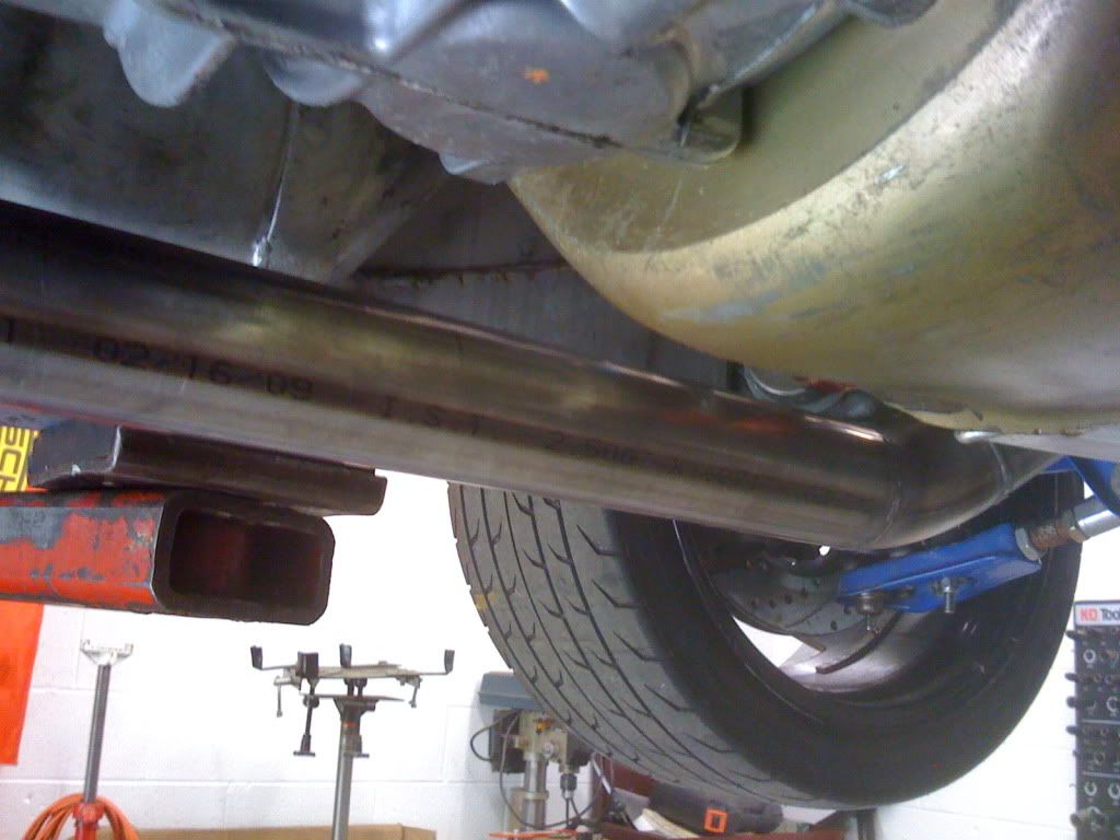

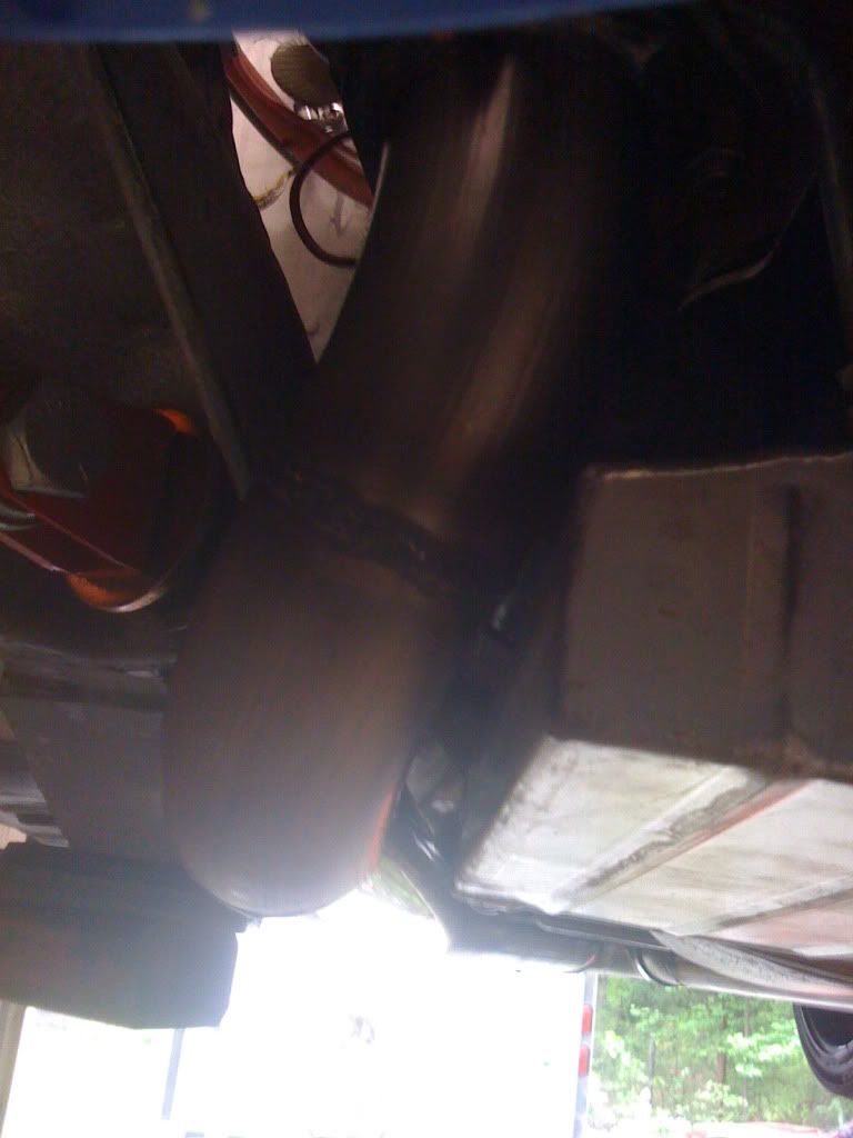

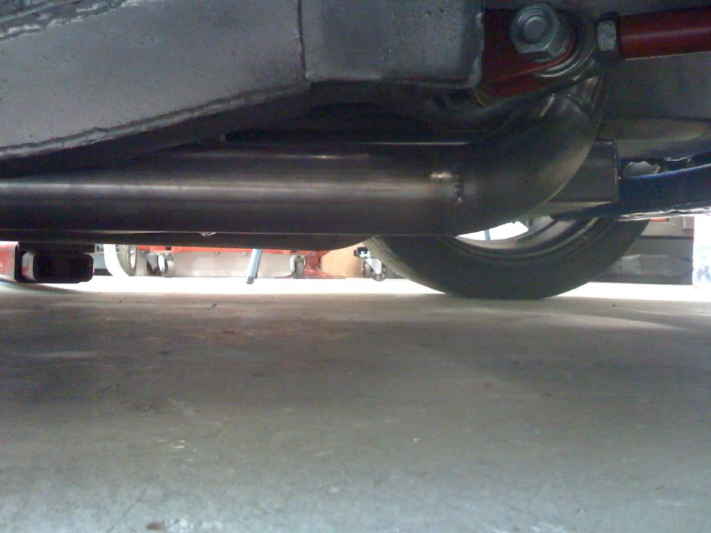

Mikelly Posted May 9, 2009 Author Share Posted May 9, 2009 The exhaust turned out well, and it is modular in design... I can remove one of three sections, or all three by simply unbolting the collectors and the three rubberized mounts... This is the third system I've had robert's custom exhaust do for me for V8Zcars and he always gets better with each design. I paid $950 and he had the car all day. All the stainless tubing was tigged, but unfortunately he didn't have stainless flanges, expipe or race mufflers in stock... I'm good with it because the car won't see much rain. The tips were slashed and turned down sections of pipe at my request... I have zero interest in flash for this car... They'll be painted black so they blend in with the lower valance... I'm going to re-route the oil lines away from the pipes, along with the red fuel return line... This stuff will all be re-routed. The passenger side downtube will also get header wrap at the oil pan section. Mike Quote Link to comment Share on other sites More sharing options...
