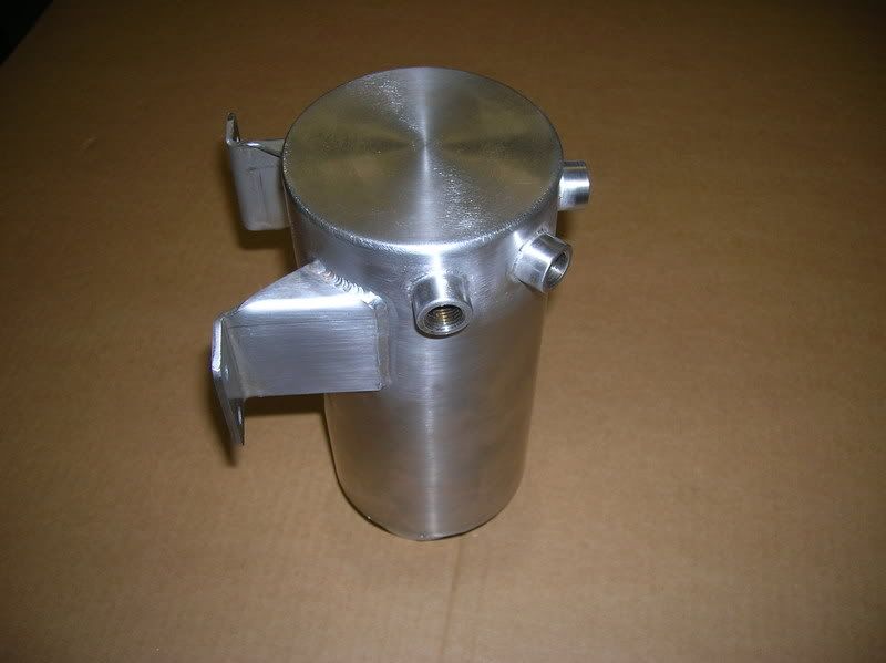

Roostmonkey Posted July 2, 2008 Share Posted July 2, 2008 Even tho I sumped the fuel cell, we're still getting some starvation on long sweepers.So next we ( ZYA,Gnosez and I ) are trying a surge tank mounted on the firewall over the battery tray with a second fuel pump. I just fabbed this up and Pete will install it this weekend and test it next week at NHIS. Hopefully this will solve the problem. Quote Link to comment Share on other sites More sharing options...

Nostalgic_hero Posted July 4, 2008 Share Posted July 4, 2008 Scotchbrite or stainless brush marks over the welds is amateur... I noticed the link at the bottom (allmetalfab.net) and saw that you guys do a bunch of commercial misc fab.... wouldnt you guys have one of these to use??? http://www.secoeng.co.uk/wd-electro-wand-20.php also, not to nitpick, but is the bottom weld seam ground down? maybe its the pic but it looks like there is a pinhole at the bottom of the tank. also, chamfering the mounting holes would prolly be a nice idea. overall, not bad. Quote Link to comment Share on other sites More sharing options...

Mayolives Posted July 5, 2008 Share Posted July 5, 2008 Roostmonkey................What is the capacity of your surge tank? Quote Link to comment Share on other sites More sharing options...

Roostmonkey Posted July 5, 2008 Author Share Posted July 5, 2008 Nostalgic...I could have gold plated it too for that real "professional look". This was made to go on a race car not a customers million dollar mantle.And if you knew about or had used the tool that you linked, you'd know that they leave a fogged area and require some hand brushing to match the surrounding surfaces. I did use a Walter Surfox machine, same tool , different brand. I use it more to passivate the weld than to remove color although thats a nice bonus. Pinholes?? Thats a good one. Mayo, its around 1 liter Quote Link to comment Share on other sites More sharing options...
Nostalgic_hero Posted July 6, 2008 Share Posted July 6, 2008 Quote: --------------------------- "Pinholes?? Thats a good one" - Sigh.. At the bottom of the tank there appears to be a divot in the shape of a small hole, look at the picture. Of course you pressure tested it to 120psi or whatever shop pressure you have, but the image still looks like there is a divot. Quote: --------------------------- "I could have gold plated it too for that real "professional look"" - you mean like the Gold Zinc finish coating for the products done by Robert Linton's tiny company (Cartridge)? Why not go the full distance and add Ti hardware like Robert did with these lowly droplinks.. Or how about the lowliest of machined brackets.. the brake caliper bracket... yet... wow, gold zinc again? I guess its not that hard after all... You should wholly be aware that whatever gets posted online is fair game for any and all criticism... Now, with that said... Please PLEASE PLEASE dont take my criticism as cheap shots, I love seeing hand made work displayed, (as it seems to be a dying art on these forums). I especially love seeing hand made work that is optimized for weight and dimensions... and i ESPECIALLY LOVE seeing it look badass while doing it:-D speaking of weight, are those tabs .100 or .128 thk? Whats the thread dimensions on the bungs? Im wondering if there are adapter fittings going on. Maybe some radiused AN pieces would have slimmed things down (Weightwise and dimensionally) in this situation??? Post some more pics of this tank!! where is the return to the main tank.. Is there a 5-8psi checkvalve going back to the main tank??? ?????? edit : JSM, yes Winter Park, Fl... but i've since moved to Ft Lauderdale... Doing crestron programming and installation in the bahamas and south florida Quote Link to comment Share on other sites More sharing options...
