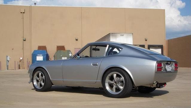

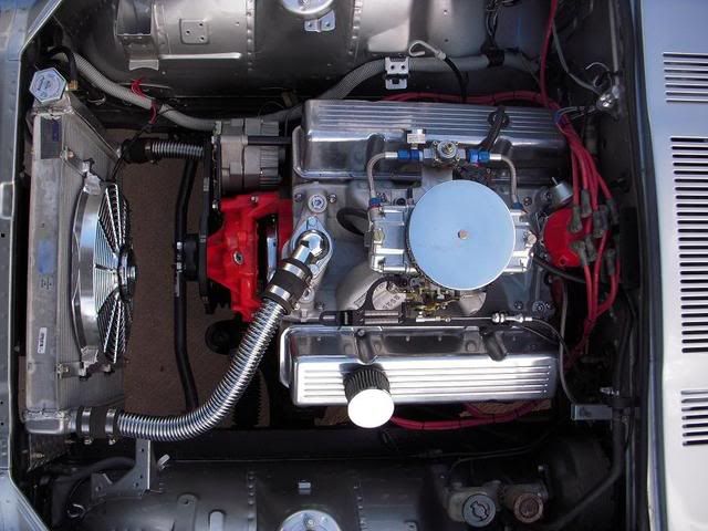

Kevin.pk Posted September 11, 2008 Share Posted September 11, 2008 I could not have done it without yall. It took 5 years since I started this project as a senior in high school (thats where I painted it) to get it on the road, but it was all worth it. It may not be completely done(still needs interior work... etc) but its finally road worthy and it is fun. Exhaust start up video at the end... The exhaust is 2 1/4" into a muffler under the driveshaft. Its a dual in, single 3" out muffler. Its 3" to the muffler in the rear stock position and a 4 inch polished tip out the back. Both mufflers are magnaflow. Its sound kind of quiet in the vid but is much louder in person. And it really opens up when you get in to it. Kevin Quote Link to comment Share on other sites More sharing options...

madkaw Posted September 12, 2008 Share Posted September 12, 2008 thanks for posting that nice Z. I have been debating colors and silver is at the top of the list. What version of silver is that? Very nice work! Quote Link to comment Share on other sites More sharing options...

Kevin.pk Posted September 12, 2008 Author Share Posted September 12, 2008 thanks for posting that nice Z. I have been debating colors and silver is at the top of the list. What version of silver is that? Very nice work! Its the silver off of the 350z. don't remember the name of it... might be chrome silver. Looks good, sounds good! I liked the ants walking by too Haha... I knew someone would notice that. Thanks for the compliments. Kevin Quote Link to comment Share on other sites More sharing options...

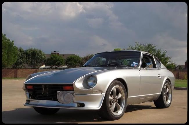

johnc Posted September 12, 2008 Share Posted September 12, 2008 Great looking car. It took me a second to figure out what that swirly thing was on the front of the car in the first picture... Quote Link to comment Share on other sites More sharing options...
Rustyfriend Posted September 12, 2008 Share Posted September 12, 2008 It took me a second to figure out what that swirly thing was on the front of the car in the first picture... at first glance i thought it was some crazy turbo Quote Link to comment Share on other sites More sharing options...

Kevin.pk Posted September 12, 2008 Author Share Posted September 12, 2008 Great looking car. It took me a second to figure out what that swirly thing was on the front of the car in the first picture... The car is just entering a wormhole. haha ... yeah just the license plate blurred as you already figured out. 280zcar Car looks great, awesome job! I also really like the color, might have to paint mine silver.What suspension are you running with those wheels and tires? Coilovers or just springs and struts?Alan No coilovers... yet (they are in the plans). Stock spring perches with tokico lowering springs and struts. Clearance is close though. I have about ~3/16"-1/4" of clearance in the rear between the tire and spring perch. The front comes very close. The wheel is millimeters away from the spring perch but doesn't rub. I did grind away at the spring perches to gain a little peace of mind. Tires are 245/45/17 Thanks Quote Link to comment Share on other sites More sharing options...
