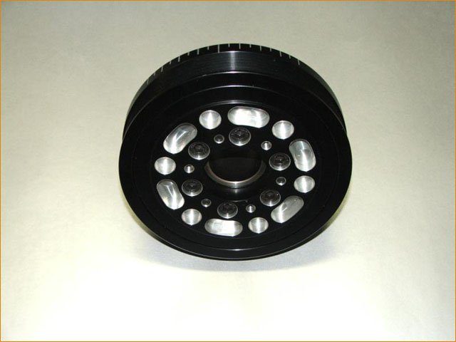

Derek Posted February 17, 2009 Author Share Posted February 17, 2009 Got the 36-1 wheels from the laser cutter and they are nice. The addition of the slots verses the clamping washers is a real improvement. I'll be shipping tomorrow or Thursday. I'll be stocking this stuff on a regular basis if anyone is interested. Thanks again everyone. Derek Quote Link to comment Share on other sites More sharing options...

clint78z Posted February 18, 2009 Share Posted February 18, 2009 Great news Derek, they look amazing. Finally I can turf my HEI module, and get a smooth idle. I am going to try and find a day I can make it out to the farm to measure the dodge coilpack for you, I know I am late on this. Thank you for making quality custom parts for the Z car, it's good to keep the flame burning on these old machines. Quote Link to comment Share on other sites More sharing options...
tech9 Posted February 20, 2009 Share Posted February 20, 2009 Stuff looks awesome, wonder if it will need to be painted / coated to prevent corrosion? Quote Link to comment Share on other sites More sharing options...
Derek Posted February 20, 2009 Author Share Posted February 20, 2009 Stuff looks awesome, wonder if it will need to be painted / coated to prevent corrosion? The wheel is cold rolled steel so it will need to be coated. Derek Quote Link to comment Share on other sites More sharing options...
