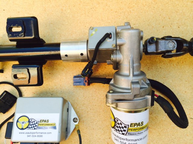

Zbuff Posted December 23, 2009 Share Posted December 23, 2009 The unit that was installed is a variable assist electric power steering. The faster you go the less assist is needed. From the small amount of time I have driven it so far. When up to speed it steers pretty much the same as before the change. Zbuff Quote Link to comment Share on other sites More sharing options...

JMortensen Posted December 23, 2009 Share Posted December 23, 2009 The unit that was installed is a variable assist electric power steering. The faster you go the less assist is needed. From the small amount of time I have driven it so far. When up to speed it steers pretty much the same as before the change. How does it know how fast you're going? Quote Link to comment Share on other sites More sharing options...
Zbuff Posted December 23, 2009 Share Posted December 23, 2009 It has speed sensors Zbuff Quote Link to comment Share on other sites More sharing options...

JMortensen Posted December 23, 2009 Share Posted December 23, 2009 Yep, The first post was accidently sent before I was finished. Please excuse my clummsyness. Thank-you so much for your compliments it is always nice when you work is appreciated. As it happens I'll be using a T56 so that might be a convenient way to go. How did you hook up a speed sensor to an old Datsun transmission? Sensor on driveshaft? Sorry for all the questions, I'm just really curious about what all is needed to get this system up and running. Quote Link to comment Share on other sites More sharing options...
NZeder Posted December 23, 2009 Share Posted December 23, 2009 I know with the setup I got from Japan (yet to be installed, and I believe the same source that Brain gets the units as shown by Zbuff) was supplied with a speed sensor that connects to the standard mechanical output from the gearbox. This sensor then passes the mechanical drive to the speedo cable. So gearbox drive ---- new speed senor ---- speedo cable For me I will not be running the speedo cable as I have a new electronic speedo. Quote Link to comment Share on other sites More sharing options...

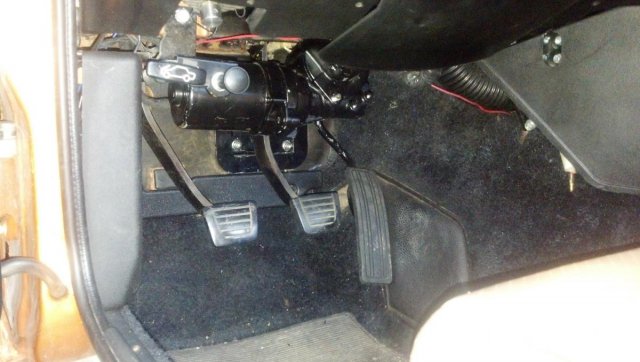

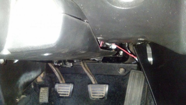

kj280z Posted October 5, 2011 Share Posted October 5, 2011 WaaaaaaHooooooo:mrgreen: Today I picked up my '76 280Z 2+2 from the shop with my new electric power steering installed. Wow, does it make a difference on how the car handles. I purchased this unit from Brian K. of zcarbum@aol.com fame. Thank you Brian your product it is a seriously very nice addition to my car. [ The unit was installed by Dustin Rinehart of Peak Performance in Eugene, Oregon. All work was extremely well done with a very nice custom application. No wires are showing, in fact I don't think anyone would notice the car even had power steering unless they got behind the wheel and drove it. I have driven it very little presently as the rain is still coming down and I have a lot of clean to do after the car has sat for the last few months at Dustin's shop. From the driving that I have done however, it is now a very manageable car. The feeling in the steering wheel is very solid and gives you confidence in the handling of the car. Now instead of using muscle by armstrong when trying to steer the car at a stop, it is a two finger job. Very easy, but not too easy to the touch. There is no noice associated at all with the opertation of the ps when in use. I will be painting the bottom portion of the (motor) black just to hide it from the most discerning eye. Now on to my next project. I'm interested in buying one of these units - I saw the unit on the JDM site and also the Unisteer unit - I like this one best (ZBuff's install) ! How can I get one? Zbuff can you "steer" me in the right direction? Quote Link to comment Share on other sites More sharing options...
