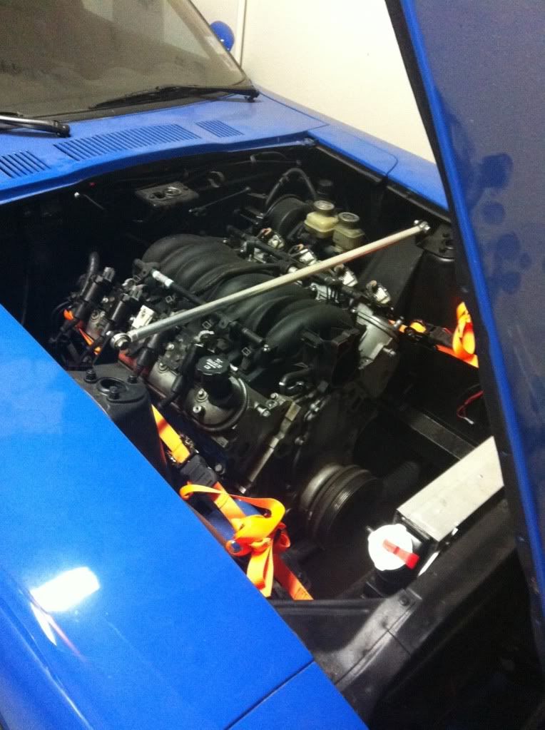

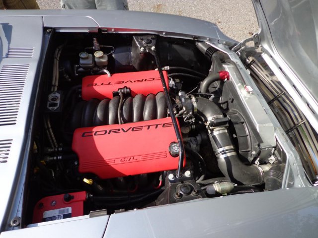

RB30X Posted June 26, 2011 Share Posted June 26, 2011 Here's my LS1 Quote Link to comment Share on other sites More sharing options...

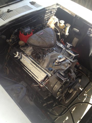

Dee Posted January 17, 2013 Share Posted January 17, 2013 (edited) SBC 350/th400 Will soon be joining the running V8 Z club, got a medium list of items to get before first startup though. Used the JTR mount kit, was a bit of a pain to get mounted -- HEI Distributor was too big, trans dipstick in the way had to to get rid of it and beat the earth, wind & fire out of the left side of the the tunnel. Edited January 20, 2013 by Dee Quote Link to comment Share on other sites More sharing options...

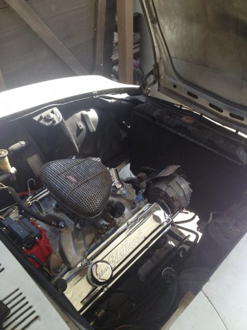

dreco Posted January 17, 2013 Share Posted January 17, 2013 (edited) still need lots of stuff before this runs, but it's getting closer Edited January 17, 2013 by dreco Quote Link to comment Share on other sites More sharing options...

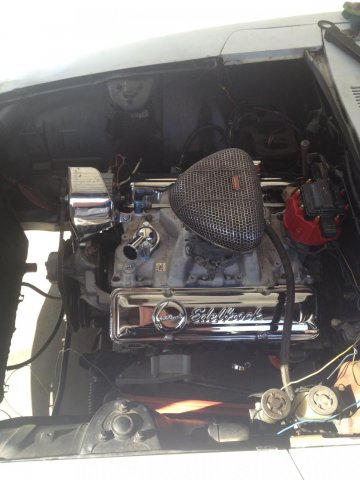

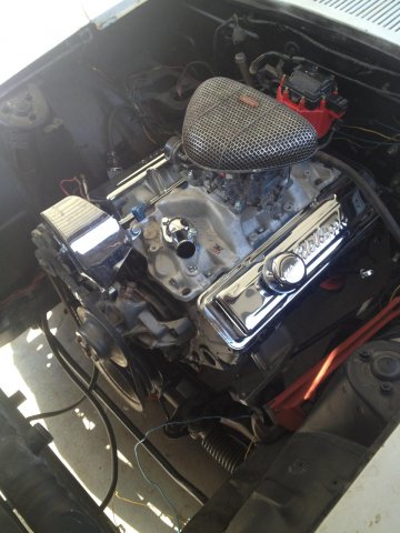

adisturbedv8z Posted January 19, 2013 Share Posted January 19, 2013 (edited) here is my '74 late 260z 350 w/ turbo 350 edelbrock 600 carb edelbrock intake sanderson headers JTR engine and transmission mounts B&M Megashifter HEI distributor w/MSD cap & rotor I'm not on the road yet, but with some work tonight and tomorrow I should have it fired up finally. I am beyond excited!! Edited January 19, 2013 by adisturbedv8z Quote Link to comment Share on other sites More sharing options...

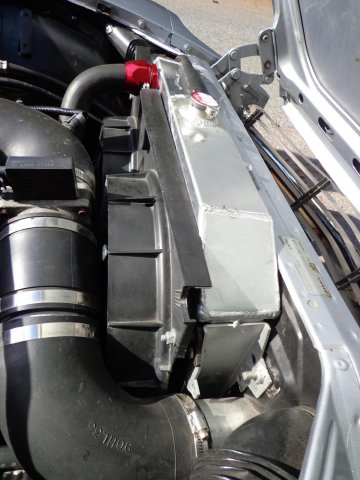

RebekahsZ Posted January 22, 2013 Share Posted January 22, 2013 jnj-where's your water pump? Quote Link to comment Share on other sites More sharing options...
jnjdragracing Posted January 23, 2013 Share Posted January 23, 2013 (edited) jnj-where's your water pump? In my intercooler(ice) tank, it is a rule 3700 billage pump.Here is a picture of the tank. The tank feeds the air to water intercooler,then goes to the trans cooler, than to the engine,then back to the tank.I can make a 1/4 mile pass drive it back to the pits and the temp will only be 140 degrees. Edited January 23, 2013 by jnjdragracing 1 Quote Link to comment Share on other sites More sharing options...
