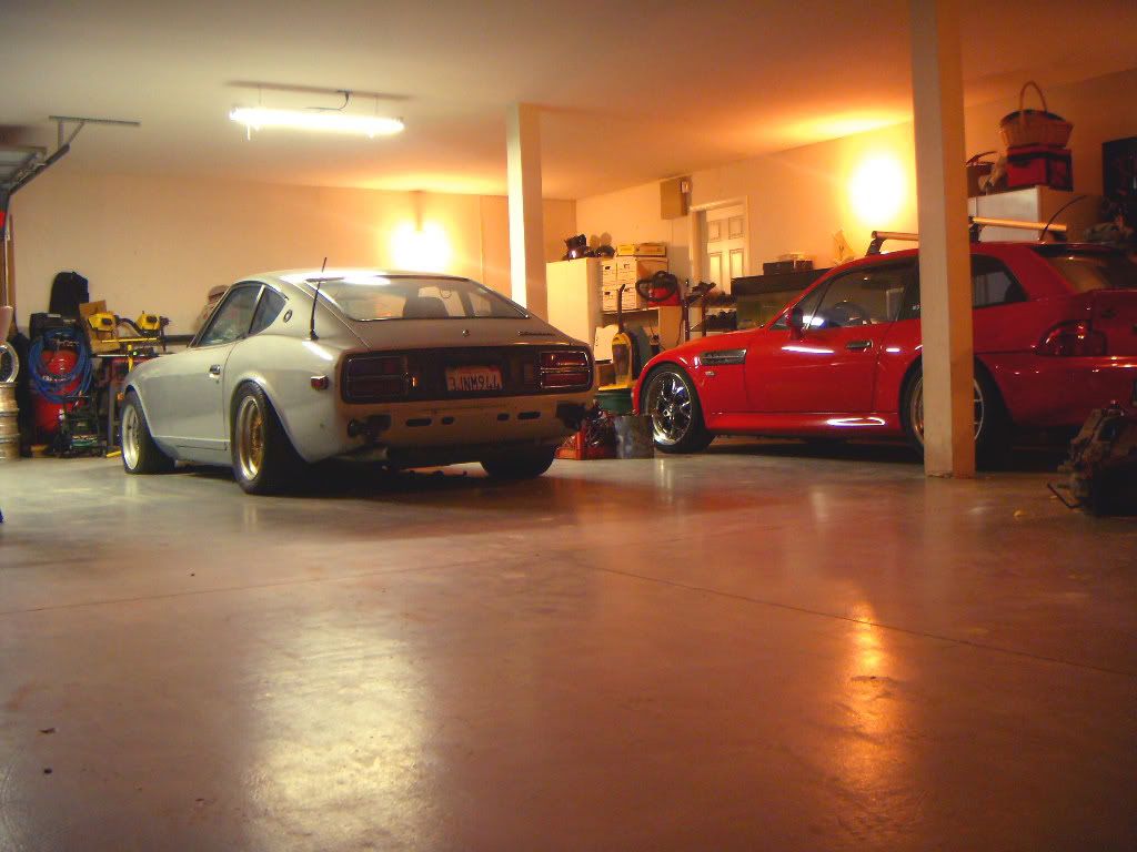

JMortensen Posted February 19, 2009 Share Posted February 19, 2009 You do know that getting your S30 that low will mean it will handle like crap, right? Not if you do it right. May not have been the fastest Z in the world, but it didn't handle like crap either. The comparison of the body line to the hubs made me check. Looks like I was right about where the car in the garage is, maybe even lower: http://videos.streetfire.net/video/2000-autox-indisde-and-outside-I-think-my_8051.htm To do it right you'll be sectioning struts, running camber plates, compensating for the low roll center, bumpsteer and a bunch of other things. I also ran mine about 3" higher than this on the street and just lowered it for autoxing. It would literally have high centered on most speedbumps the way it was set up in the video. Quote Link to comment Share on other sites More sharing options...
