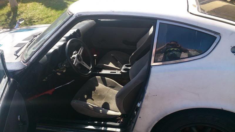

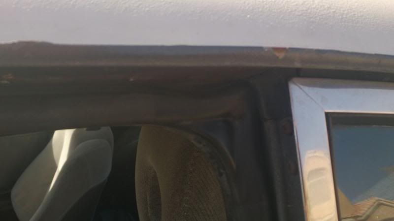

mildsquare Posted March 8, 2014 Share Posted March 8, 2014 Hello all, I just installed front Door seals from a 2003 hyundai elantra GT, and a Hatch seal from a 1990 Honda crx. With a bit of trimming everything fit fine and seems to seal rather well.the Elantra Trim also has a nice ear piec that sticks right into the corner of the door frame. I don't have internet on my phone but I'll try and snag my gf's to take some pics and post them up. Quote Link to comment Share on other sites More sharing options...
socorob Posted March 8, 2014 Share Posted March 8, 2014 Looking around the junkyard, most cars around early 2000s used very similar door trim, We took some off a Kia, ranger and another car, and when we got back to the shop we couldn't tell which was which. Quote Link to comment Share on other sites More sharing options...
mildsquare Posted March 19, 2014 Share Posted March 19, 2014 Took long enough, but I Have some pics!! the Corner Piece I was refering to in my previous post. I took it to a self service car wash and sprayed the heck out of the doors. It held up well, my seats were dry for the first time after a wash! Quote Link to comment Share on other sites More sharing options...
