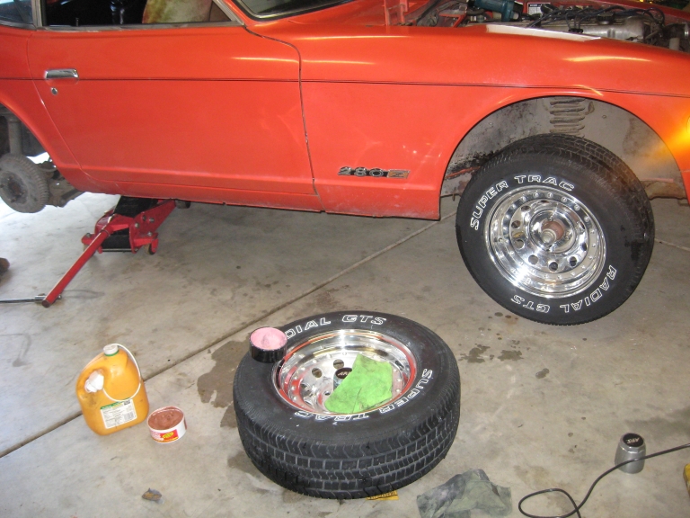

Sketch_hs Posted November 2, 2009 Author Share Posted November 2, 2009 WHEEL POLISHING IS A BITCH! I don't think they have seen more than soap and water in 35 years One kinda done after a couple hours (no joke!) lots of imperfections but my hands hurt. This is hard work! BEFORE been cleaning up inside a bit... lots more will be done in here later whats going on in your garage? Quote Link to comment Share on other sites More sharing options...
