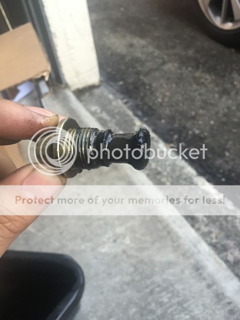

seattlejester Posted May 31, 2016 Author Share Posted May 31, 2016 You can see why I was irritated, finger is close to perpendicular. That bolt is screwed, hopefully it didn't rip through the seat mount. Figured I would install my new trans mount since it was sitting on the shelf. Put the car up and realized that I need to take the exhaust off again which is quite an ordeal to do for one person. I think I might take it back to the exhaust shop and have them install another v-band in the middle to make it easier to remove, also the exhaust touches the trans cross member so they could deal with that as well. Noticed that the trans mount is missing a retaining nut and a bolt to mount to the transmission. I never gave it two looks when I got the transmission, seems more and more like this guy just threw some parts on his old transmission and sold it to me. That might account for the rattling and such. Painted my other wheels with the bigger tires. Also tried my hand at the white lettering. Kumho isn't a great name for a tire, I probably should have left it out, with the two it looks a bit too american for some reason. I think the konig has a better design. Mesh wheels just make the car look off, reminds me of jeep wheels from the 90's. The lettering also doesn't help either. I don't know, I'll have to think about it. The konig's for comparison look much better despite the tiny tires. Metal ordered for my tubular bumper along with a new fuel cell cap. Turns out the diameter is too big for the retaining tab on the cap. I basically ruined mine figuring that out so I should be able to get this one to fit nicely without grinding most of the tab away. Found a pretty good deal on some Sparco seats, a little sooner then I had planned, but combined with my F'd up seat bolts I might just bring the schedule forward for getting those installed with the new harnesses. Also welded holes and cracks in the spare driver door shut and threw some primer on. Pretty excited to have a working windows on both sides. More to come, there is a car show on the 12th, I am shooting for. Nothing big or special, but would be nice to be mostly complete. Quote Link to comment Share on other sites More sharing options...

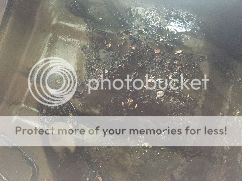

seattlejester Posted June 24, 2016 Author Share Posted June 24, 2016 (edited) Sludge all over my magnetic drain plug. Pulled some of the oil out of the pan that was sitting at the bottom after the oil drained, and put it on top and let the oil drain away. Came back to all these bits of metal. Surprisingly I didn't find any rod ends. Given the absolute clatter I was expecting to find bolts, nuts, and rod caps if not crank caps, but all of them are in place. These big chunks do point towards me finding a couple rod bearings missing. I took one of the rod caps out and was surprised to see a bearing in good condition. Given my limited space no real ability to use a hoist, there was some talk about this being the end. Talk about parting out and cleaning up and such did come up and I have to admit there was a part of me that wasn't too opposed. I could pay off my lease on my car and start saving and buy something else down the road. Adding the part out however shed some light on things. I had an upgraded 7mgte specific turbo that I had paid good money for, valve covers that I never got a chance to install, and some parts that I would really have a difficult time parting out like my bare shell. Then there is always the concern that I would part out my suspension or something critical to the car functioning as a car and then find no one wants parts which would leave me absolutely screwed. So my plan is to do a complete tear down with the block in the car for the most part. Take off all the accessories and manifolds, then remove the head, jack up the engine via the transmission. Then pop out pistons and rods one by one. After which I will hopefully be able to identify where all this bearing material came from and if the crank and the block survived. If not I should be able to lift the block out as the bare block only weighs 130lbs. I can have it machined and rebuilt it and my friend's parents heard of my mishap and offered their driveway for a weekend, so I could put it in that way. I also figure a complete running car will fetch more then a part out. And I STILL haven't driven this thing in anger. This was my first drive after my alignment and I had just sunk like 3k into the suspension. I really want to get some use out of this thing. Then there was talk about the rebuild. I talked to some people, I was thinking maybe I should go all out and just do forged rods and pistons etc, but the consensus seems to be that the return is always going to concerning as it is not as stout a block as a 2jz. In the scheme of things a used 2jz almost fetches as much if not more then a built up 7m. An engine builder familiar with the engine said the stock rods are good to about 500hp, and the forums say the stock pistons should be able to withstand 400whp. I don't plan on going above that, and I have to say I am a bit fickle and not sure this will be the last power plant to grace this engine bay. The rebuild parts are actually not that bad, I think about 600 for new pistons, rings, bearings, seals, gaskets, thermostat, ARP bolts, and a set of used rods. There is a bit of "while I'm at it" in the form of doing some reliability, flow, and quality of life upgrades in regards to the oil in the form of a new cross over pipe, higher volume/pressure oil pump, and AN feed and return lines in addition to AN lines and adapters for the culprit which was the loose worm drive clamp, that is going to set me back about another 7-800. The clutch would be my next weak point and is a reused stock unit with unknown miles. Throwing in my light weight fly wheel with a new friction disc, a higher rated pressure plate and a new clutch and a new starter is going to set me back another 7-800, but would allow the power to get to the wheels without problems. All in about 2k just in parts. I'm really hoping to get away with minimal machine work in the form of resizing rods, maybe a deglazing of the cylinders and a polishing of the crank, not adding up to more then 500 would be great. Theory would be that after this I still have a shelf of parts to install and solutions to come up with for things like a heater that should keep me occupied. The power will be reliable and stout at the 350-400whp mark. That is the plan. Edited June 28, 2016 by seattlejester Quote Link to comment Share on other sites More sharing options...
