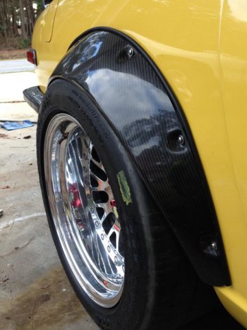

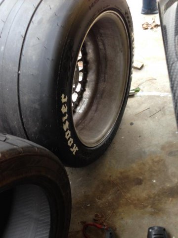

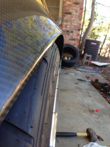

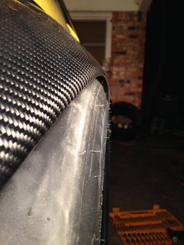

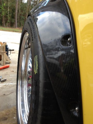

ZT-R Posted January 20, 2015 Author Share Posted January 20, 2015 In the meantime i ordered some 335/35/17 slicks and some wider butter lips. I doubt it will fit but "imma try". Quote Link to comment Share on other sites More sharing options...

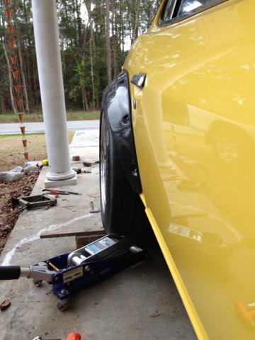

ZT-R Posted January 28, 2015 Author Share Posted January 28, 2015 Ahhhhh soo close.... i could raise the car about 1/2 inch and it would be fine but ehhh i guess ill try the 315s, just sucks to loose almost an inch of tire. Quote Link to comment Share on other sites More sharing options...

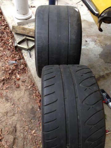

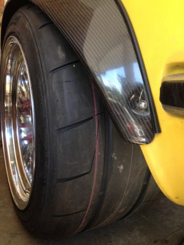

ZT-R Posted February 20, 2015 Author Share Posted February 20, 2015 Well the 335 looked mean as hell, but not quite practical on the street. so i went with 315. grrrrr..... Quote Link to comment Share on other sites More sharing options...
EF Ian Posted February 25, 2015 Share Posted February 25, 2015 315 is pretty wide, surely that enough rubber? If not you need some traction control or less power. I think 335 would look to wide when viewed from behind the car because S30 are quite small cars, it would look really over tyred. Quote Link to comment Share on other sites More sharing options...
ZT-R Posted March 1, 2015 Author Share Posted March 1, 2015 People say damn that some tire on that thing when i had the 295's on there. ha she gets better traction but i have only driven it once on the new tires, weather has been crappy, either cold or raining. I need to get it to the dyno anyway. Quote Link to comment Share on other sites More sharing options...
