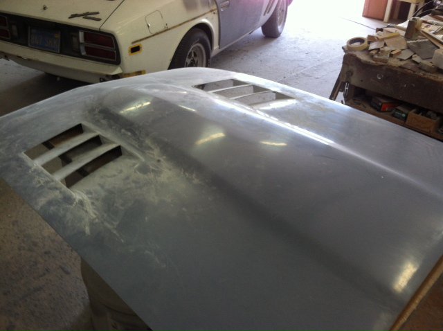

A lip will help creat a lower pressure area over the hood vents, but it's already a low pressure area compared to underhood. Adding a lip adds drag.
Have you measured underhood temps at idle and at speed? Do you need to increase the low pressure above the vents to drop underhood temps? Will that decrease in onderhood temps offset the drag of the lip?
I suggest you run the hood as is and measure. I've measured underhood temps with my racing L6 and it was within 10 degrees of ambient once the speed reached 30mph. That's with a stock style CF hood and vents in the inner wheel well.
