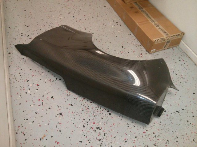

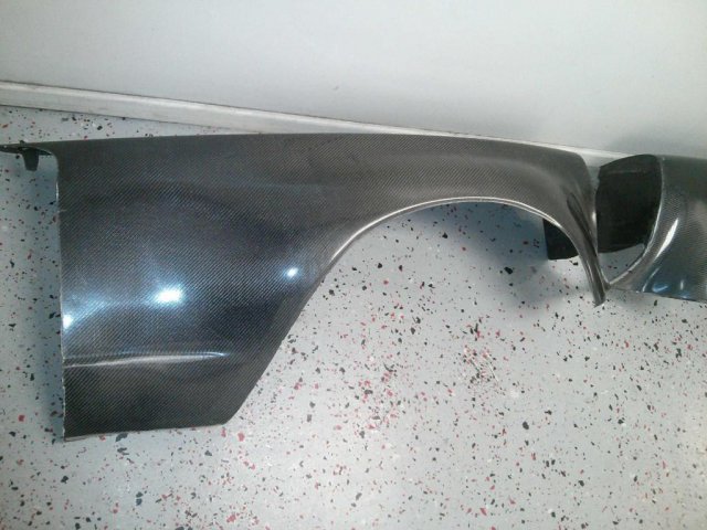

cobramatt Posted January 16, 2014 Author Share Posted January 16, 2014 Received the first of the new Carbon Fiber body panels today. WOW........ The fender weighs 3 lbs. Now were cookin' with gasoline......... We were about to chop the front off and start on the front tube clip when we had a brilliant idea. How about lets send the car to the frame shop and have them put it on the big expensive machine that determines if the rest of the chassis is straight before we spend all this time and money building something new that is based on bent geometry. Its sometimes the most obvious things that get overlooked in any build and even some of the best, not implying that I'm one of the best but I've built a few, suffer from the same issues. Quote Link to comment Share on other sites More sharing options...

tube80z Posted January 16, 2014 Share Posted January 16, 2014 We were about to chop the front off and start on the front tube clip when we had a brilliant idea. How about lets send the car to the frame shop and have them put it on the big expensive machine that determines if the rest of the chassis is straight before we spend all this time and money building something new that is based on bent geometry. Its sometimes the most obvious things that get overlooked in any build and even some of the best, not implying that I'm one of the best but I've built a few, suffer from the same issues. That's a great plan. I built a perfect tube frame replica of a bent car once. had thought since all the body lines were straight and the car drove nice it was okay. Always measure first. Never will make the mistake again. I'm also very curious about the panels and the roof. Would love to know how much weight that can drop. Cary Quote Link to comment Share on other sites More sharing options...

cobramatt Posted January 17, 2014 Author Share Posted January 17, 2014 Those are slick! Can't wait to see the new roof. I am axious to see the roof as well. Since my car has the cage I am not worried about this being structural. If the car didn't have such an extensive cage this roof would not work. It will however in this application, I believe drop more weight than any other item I'm replacing on the car. I have an exact weight prior to transformation so we will see the exact savings in the finished product. Quote Link to comment Share on other sites More sharing options...
cobramatt Posted January 17, 2014 Author Share Posted January 17, 2014 That's a great plan. I built a perfect tube frame replica of a bent car once. had thought since all the body lines were straight and the car drove nice it was okay. Always measure first. Never will make the mistake again. I'm also very curious about the panels and the roof. Would love to know how much weight that can drop. Cary I knew there would be someone who could relate to how something this important could easily get overlooked. I'm so focused on how the build is going to come together and the timeline, It never even crossed my mind. I'm glad I have other people around me. My 24 year old fabricator at the shop is the one who said, "Don't you think we should make sure the rear of the chassis is straight before we build the front clip"? The rest of us sat there and looked at each other.......... Quote Link to comment Share on other sites More sharing options...
cobramatt Posted January 17, 2014 Author Share Posted January 17, 2014 Makes me want to go smash my car into a wall.... I guess those will wind up getting painted (?), such a pity Don't go and smash your car into the wall just to get new fenders. Start racing and you'll hit the wall eventually I assure you. Come to think of it, I almost put your car in the wall last time I drove it. I will be wrapping the car in Vinyl like I did before. It is cheaper (their one of my sponsors) and easy to fix. I do however admit that paint would be slightly lighter.......... Quote Link to comment Share on other sites More sharing options...
