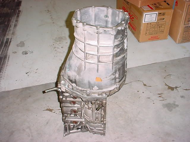

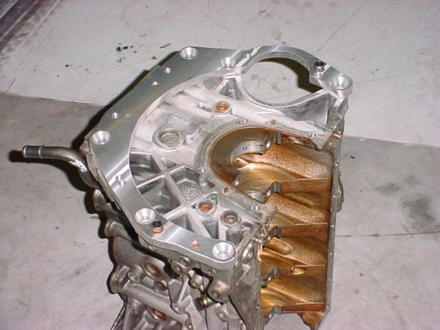

We all know that we can put KA trannies on our L28's. We all know that SR trannies are the same as KA trannies just with a different bellhousing.
Well here you go, this is a z32 trans bolted to a SR block!
Posted Image
Posted Image
Ok so there is a company that is doing this swap, you give them your Z32 bellhousing and they make it fit your SR or KA.
So we know there KA and SR are very similar bellhousings to the L28. So why not send this company an L bell and a z32 bell and have em fab it up?
Tell me why this wont work?

A local guy is making those adaptors. (Don't know if it is the same guy as that one). I saw one last week in his shop...
I was discussing making one for our L28's with him as well. If there is enough interest, then it would be worth making a run...
Mike

The KA doesn't bolt up to the L28. The ones being utilized are a hybrid, front half of a L28 five speed housing mated to the KA five speed. You need to do some machne work to the housing. There is a posting on the Atlantic ZClub site and a thread on this site.

ecp48- Garrett is running a KA trans behind his l28.
Garrett- I just spoke to Mark (www.Mazworx.com) and that is his adaptor. He posted those pics last week on the SR forums. I will be bringing him an L28 bell housing to make a Z32TT trans adaptor. I am not in a major rush to put it in the car, but I'll keep you all posted as to the progress once it is made...
