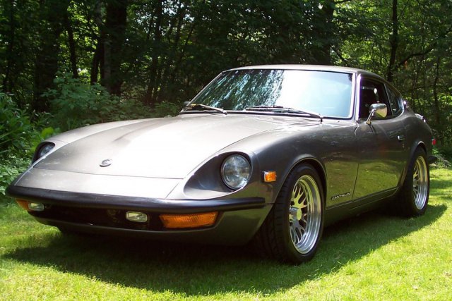

I'm running 16x8 Rota RBR with 225/50/16. They are +10 offset with 8mm wheel spacers on all for 4.   I had to trim the lip on the rear about 1/4 inch. The inside of the rears have about 1/8-3/16" clearance from tire to spring.  On the front I had to trim just the lower front portion of the wheel well so it wouldn't hit while turning. I have the stock front valance with a BRE spook. If you were running an air dam like the MSA type I the front wouldn't need trimming.  If the rims were available in +04 offset when I bought them that would have been my choice because you wouldn't need spacers.
I'm running BFG KDW2's. All tires are a little different in dimension even if the are the same exact advertised size. It's less about what size rim fits, and more about the tires size when it's mounted on a particular rim.  I don't like it myself, but a undersized tire stretched to fit an 8" wide rim could easily fit without any trimming.
My suspension is Eibach lowering springs on KYB struts. It sits about 1 1/2" lower than stock.  I had to cut 1 coil from the progressive front springs to remove the nose up look. The top 4 coils were completely compressed when sitting still so it didn't have any effect on the effective spring rate.

I got the headlight covers from Japan 2 years after that picture was taken in 2003. Took me two years to get around to putting them on.
Added a lower air dam and splitter in 2009. Seems to work (stable at 140+)
If you look real close you can see the flat section of the front fender along the arc of the wheel.
The flat on the rears were rolled out to form the slightly flared lip.
Share this post
