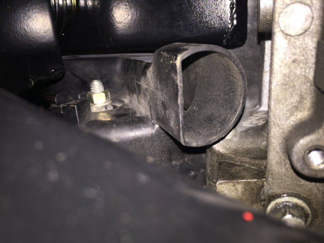

I can add a little to the CX thread. I have no issue with the kits other than the height makes it a little difficult to fit a 4L80e in the trans tunnel of a 240z. The kits fits well and is constructed well. My Transmission mount was welded slightly crooked and after sending in a few emails CX racing, they never answered. I called and left two messages, again, no returned calls. I'm going auto so it doesn't matter much to me other than the monetary loss.
Here is a few picture of the clearance. Oil pan is the C5 batwing which is the shallowest of pans out there.It sits about 1" above the cross member. Keep in mind the engine is slightly tipped back because the trans is out currently.
#190 Ryan Merrill
Ryan Merrill
    Always Here
  • Members
  • PipPipPipPip
  • 363 posts
  • LocationNewcastle Ontario
Posted 10 October 2016 - 02:51 PM
This is my problem with the CX Trans Mount kit, its not square
