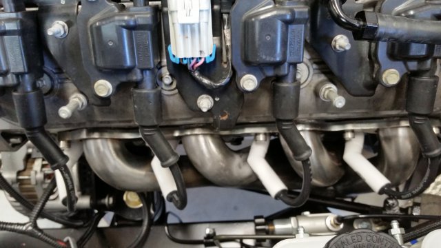

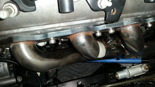

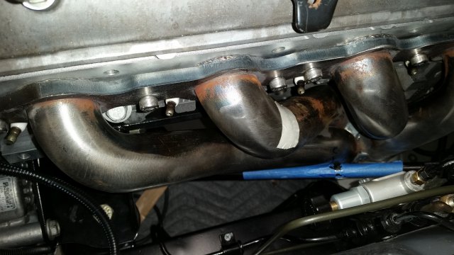

30 ounce 2 Posted November 1, 2017 Oh, the exhaust manifold/Headers. Just looking at it sure looks like the stock one will be a problem. It dumps right where our steering shaft exits the firewall. Share this post Link to post Share on other sites

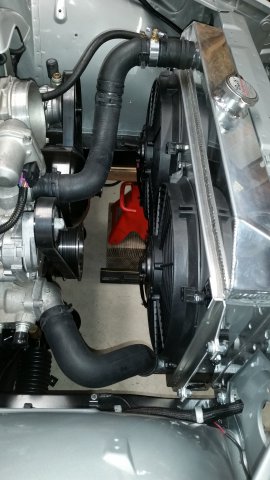

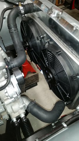

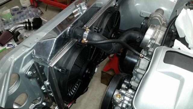

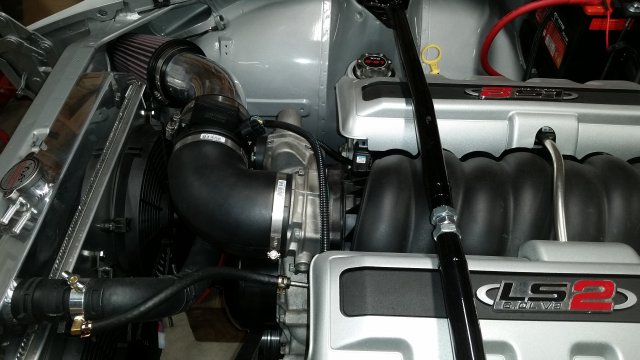

mrk3cobra 2 Posted November 28, 2017 I made some progress on the coolant system. Found some nice coolant hoses that fit almost perfect. Share this post Link to post Share on other sites

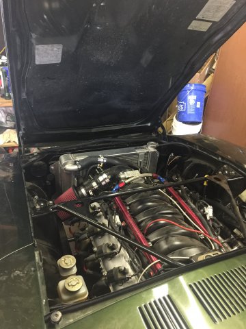

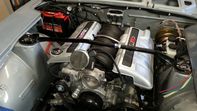

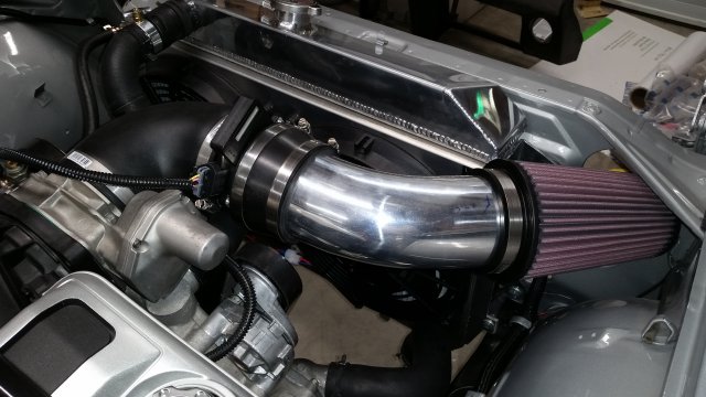

mrk3cobra 2 Posted November 28, 2017 I finished the intake. I just need to determine how to connect the valve cover vent for the PCV system. Share this post Link to post Share on other sites
Ironhead 3 Posted November 28, 2017 Looking very tidy, good work! Where did you get the radiator/fan shroud? Looks like a nice unit. Share this post Link to post Share on other sites
nullbound 16 Posted November 28, 2017 Looks great. Got any part numbers for those radiator hoses? Share this post Link to post Share on other sites
mrk3cobra 2 Posted November 28, 2017 I bought the radiator from Ledfoot Racing, the radiator is a 3 core Champion, and the shroud is made by Ledfoot racing. Share this post Link to post Share on other sites
mrk3cobra 2 Posted November 28, 2017 The bottom hose Dayco #C7039 The top hose is made up of two hoses Dayco #D72039 is connected to the engine. Dayco D70704 is connected to the radiator. Bought hoses at Autozone. 1 Share this post Link to post Share on other sites
JoeK 2 Posted November 29, 2017 Very nice looking. My set up is very similar to your routing, though I don't think I would have space to put the steam vent fitting in that spot. Mine is curretly lower down, about halfway along the vertical portion of the upper hose. Not sure if its in the right spot, worried I may not be able to bleed it if its not at the top like yours. Share this post Link to post Share on other sites

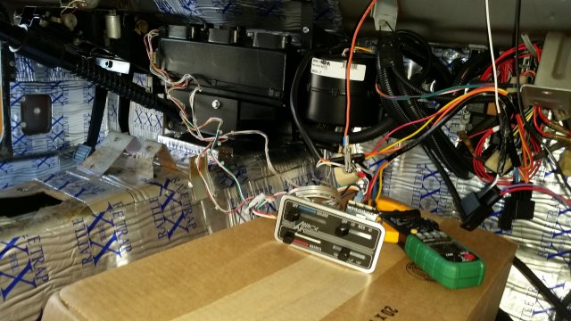

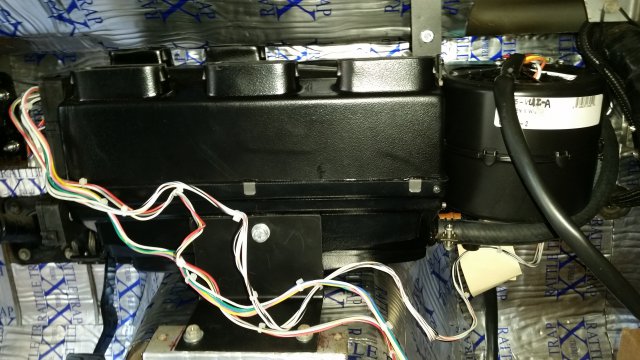

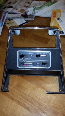

mrk3cobra 2 Posted December 5, 2017 Installed Vintage air mini Gen 2. Will add AC in the future after car is up and running. Share this post Link to post Share on other sites

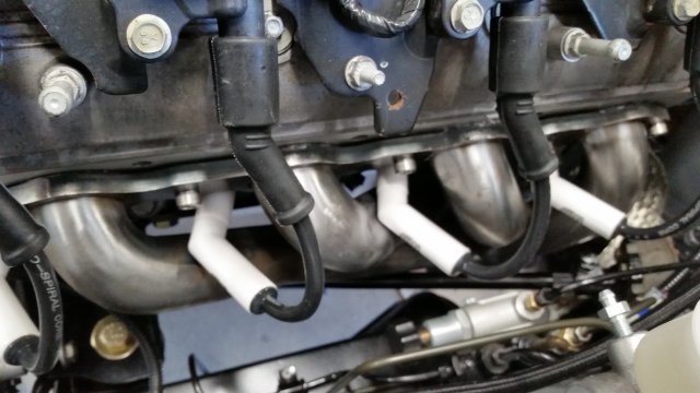

mrk3cobra 2 Posted December 13, 2017 I received the custom passenger header from Sanderson, that works with the Hoke performance kit. Next I will finish the suspension and brakes. Share this post Link to post Share on other sites

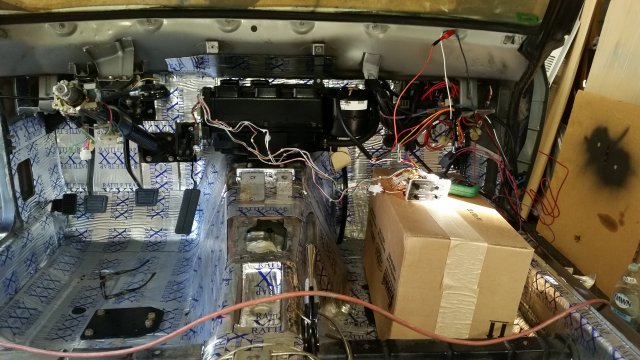

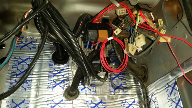

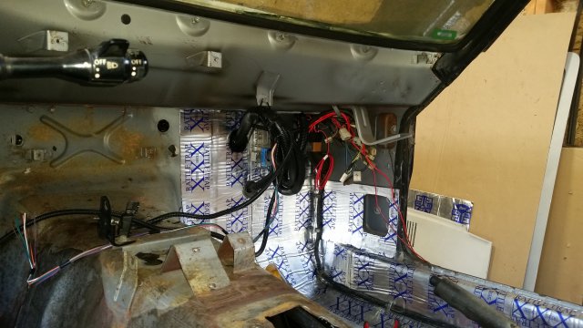

mrk3cobra 2 Posted January 17 I have been working on the wiring behind the dash, removing unused wires and adding relays. Finally completed the restoration of the dash. My dash had many wide crakes. The results are great looks just like new. Will have to see how it holds up in the weather. If it does not hold up I have a full cover that I have fitted on the dash and it fits great. Waiting on my custom made 4 1/2" GPS speedometer. The gauge will have a high beam light, and I will use the blinker lights as the emergency brake light (they will make the gauge with red lights). It will have a remote jack button since I will install in the factory gauge bracket. They also made the brake light and high beam light work on a ground signal instead of a 12 volt signal. They also shorten the GPS wire from 15' to 5'. Great customer service. I also wired the ECU engine light to the volt meter 12 volt red light. Share this post Link to post Share on other sites
