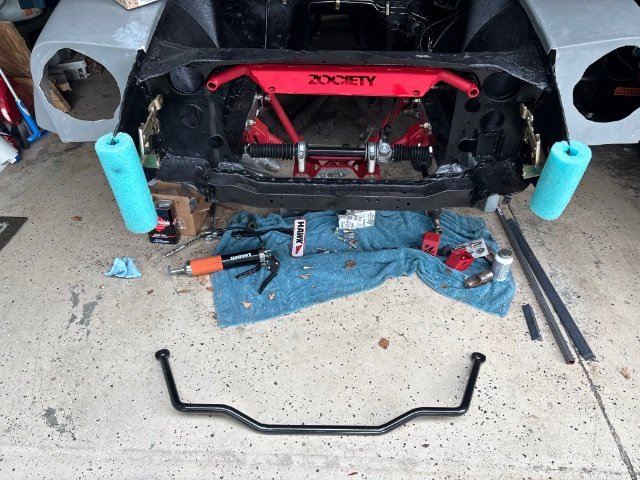

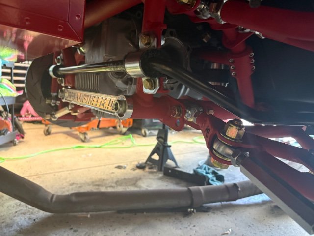

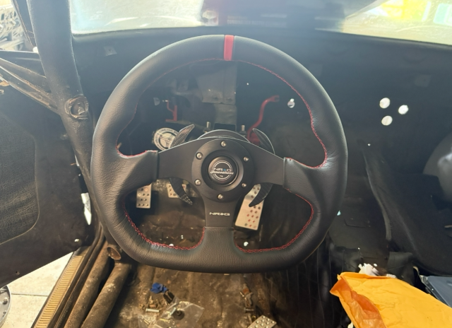

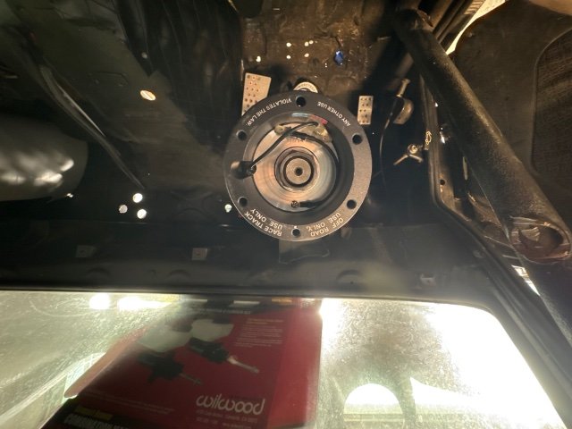

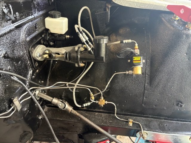

Got a few minor things done today. Front and rear sway bars are on. Got the steering column mounted and quick release steering wheel installed. Also plumbed up the line-lock, just need to clean it up a bit and the fronts are ready for fluid. - Today
