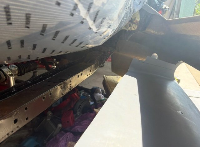

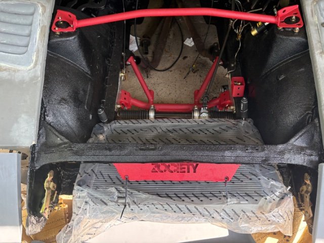

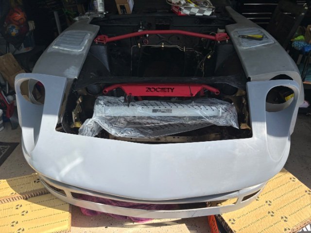

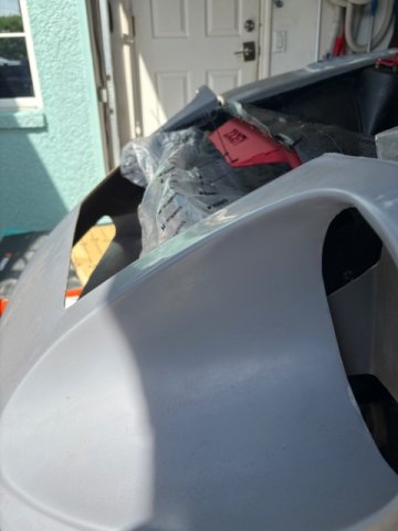

Radiator came in, made a mistake on sizing it, but I think it still works just fine sitting on the frame rails, thoughts? Or should it get something skinnier that fits between the frame rails. I like the built in tray on this bumper, I’ll add some ducting that just continues this on to that bottom rail and continue it past to the end of the radiator. -
