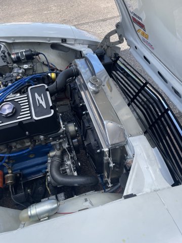

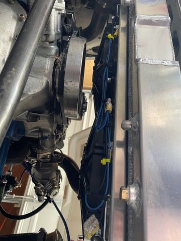

07-25-2025. I had a couple hours today, so I decided to see if the radiator would bolt in. Since June of 2021 I have been building my Z car. This is FIRST aftermarket part EVER to bolt right in. I didn't have to mod it at all. I was speechless. Granted, swapping the fans out to the SPAL fans required drilling and playing with it to get it done. However, I was able to drop the radiator and the fan should assembly right in. It is still loose, but it is there, hoses on, loose, but the idea today was......with a little time to see how far I could get it together, it literally just fell together. So "cubauto" on Amazon, there radiator for our Z cars goes right in! Now, the overflow tube on the cap was put on crooked, so I have to live with that, that is the only negative in an overall very nice looking package. Because of the size of my remaining port on the thermostat housing, using a sensor to turn the fans on and off isn't going to work. Being that my Z is just an around town toy, I will be turning the fans on and off via toggle switch. The remaining switch is 20A rated, but I ordered a switch that externally looks the same but is 30A rated to swap in. I will be feeding both fans with 10 gauge wire which is 30A rated and will forgo using a relay. 30 fA use and it will be basic, clean, and work. I swapped out the 19 lb radiator cap for the facotry 13 lb one for now. Pics follow. Good few hours today! Cheers! -
