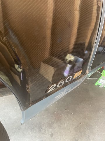

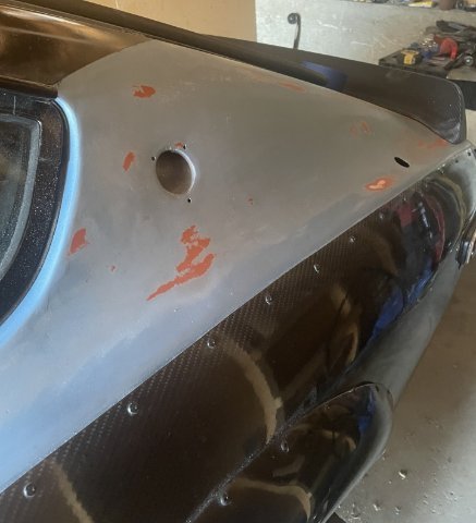

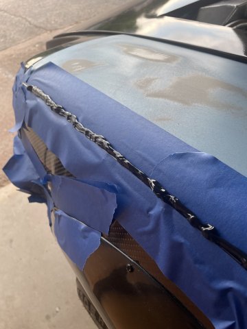

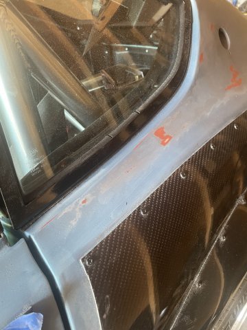

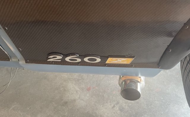

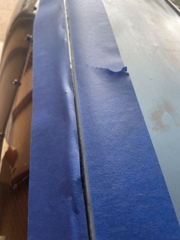

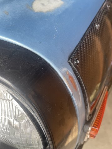

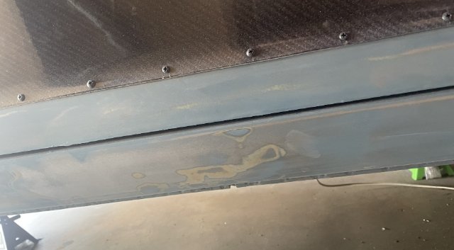

07-05-2026 ATLAS Z UPDATE: I finished feathering out the remaining blue paint, got it nice and smooth, then blew the car off and taped up the front fender and went ahead and caulked the seams. 260Z Fender Badge placement on the fenders looks good. Poppy's Patina Gloss arrives tomorrow, so we continue on! PICS:

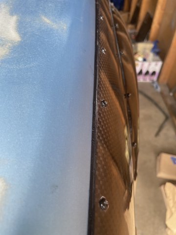

07-04-2026 ATLAS Z UPDATE. HAPPY 4TH OF JULY! I removed the front bumper and traced out and cut some spots in the carbon fiber to allow it to fit properly and re-installed the bumper. The edges will be hidden under a thin line of black silicone caulk. I also cut some aluminum stock I had and placed it under the intercooler and Tek screwed it down. it is basically just helping to support the weight. The 260Z fender emblems are on, taped to sit overnight and let the silicone cure. The rest of the day was spent fixing the other Z car I have. PICS:

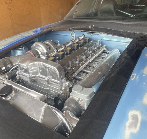

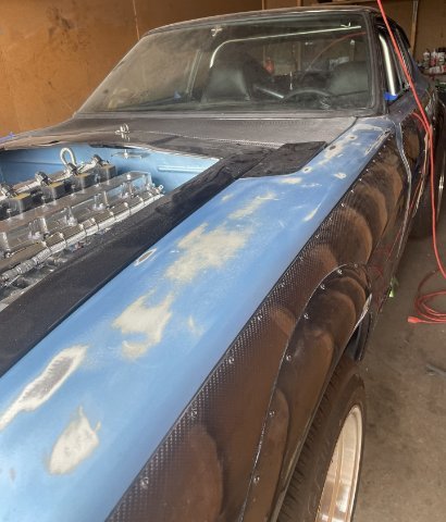

07-01-2026 ATLAS Z UPDATE: Well in between working on my other Z, I am still working on this Z car. I went ahead and started working on getting the blue painted portions of the body ready for clear coating, and caulking the border of the carbon fiber pieces. Initially I had planned to paint on a fresh coat of factory blue before clear, but I think I may go with the patina finish that is left after smoothing out the paint and getting it ready for the next step. Using "Poppy's Patina" in a high gloss finish....2 coats.....apply and then the next day apply again for 2 coats is the plan for now. This car is meant to just have fun with. It's the project car while I have the other Z anyway. my 240Z is giving me some timing issues to contend with so I have plenty to do. Also put my water meth pump on some steel to start getting the ideas flowing. PICS:
