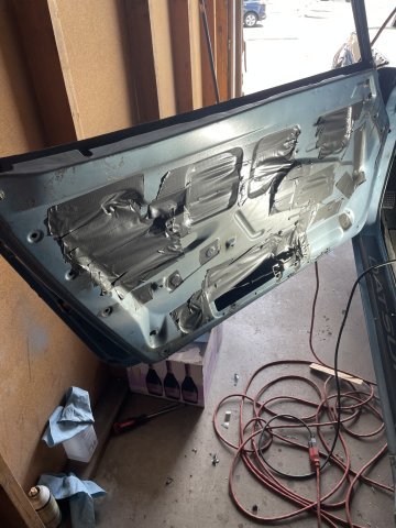

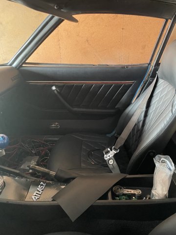

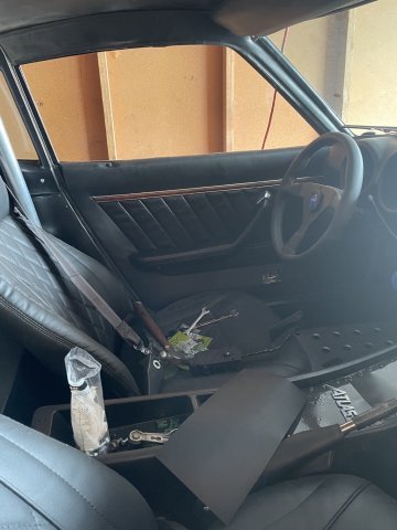

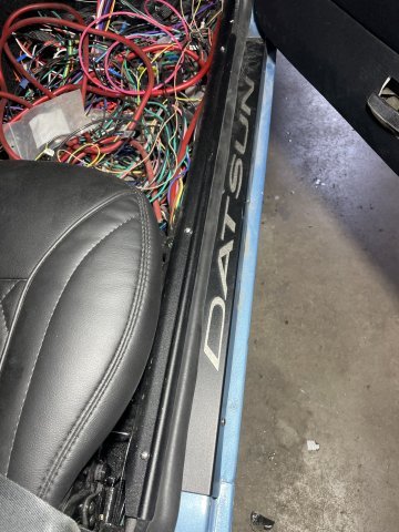

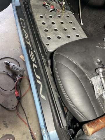

07-18-2026 ATLAS Z UPDATE: Today was Doors Day. I put this off for a long time, because it is just no fun. I deleted the windows for the car to lighten it up and keep it in the mindset of being basically a 4 wheeled motorcycle. I gutted the doors out except for the door handle mechanisms, leaving the locks in....and then vacuuming the bottoms of the doors out and then taping the holes off, and then I installed my repro door "cards" I got from Hung Vu. the Arm rests I got from Ebay and the holes left for window crank and door lock I filled with some push in plastic plugs I got off of eBay as well. I then started on the layout for the rear window. I am replacing the glass with Clear Polycarbonate from a company in England called Plastics4Performance (.com). I am getting the rear window in clear, with the special hardened coating, and making it a custom order, having slots cut into it like they do for the Ferrari 488 cars (see pic). The weight will be easily half of what the heavy glass weights, and I will lay down a layer of rubber int he window well, drop the glass in, and then with holes already drilled, bolt the window down into the hatch itself. It should look great! I also installed the door weatherstripping and the threshold plates. Seems to have made a big difference looking at it after I was done today. PICS:

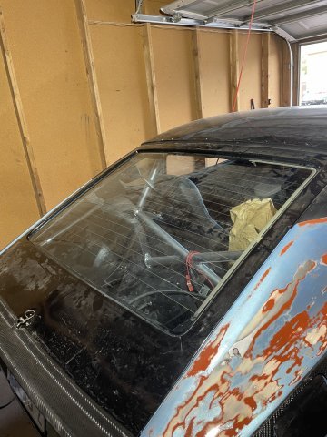

07-09-2026 ATLAS Z UPDATE: Installed the intake piping. You can see the inspection door covers on the car from ZOCIETY, still just laying there I haven't bonded them down yet. Time to finish caulking in the carbon panels and then clear coat over the blue patina paint. PICS:

07-05-2026 ATLAS Z UPDATE: I finished feathering out the remaining blue paint, got it nice and smooth, then blew the car off and taped up the front fender and went ahead and caulked the seams. 260Z Fender Badge placement on the fenders looks good. Poppy's Patina Gloss arrives tomorrow, so we continue on! PICS:
