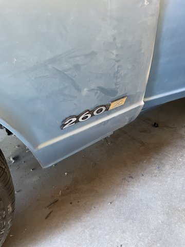

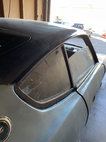

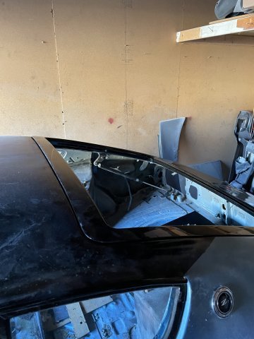

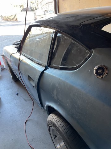

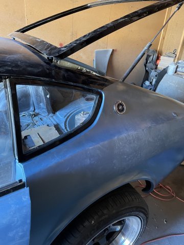

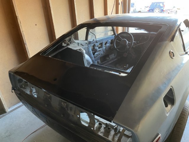

01-21-2026 UPDATE: I started the day vacuuming out the entire interior......A ton of bondo dust, and junk.....finally got it out. Later I will just have to mop it out and a light vac and it will be okay. I then installed my quarter windows, the drip rails, and the rear hatch. Installed the inspection doors and then installed the new parking lamps I got off of eBay, the sail panel emblems, and front fender emblems. A tad bit of clear caulk to help keep them tight against the metal like I want. I was also able to clean out the garage, throw away a lot of stuff no longer needed, empty boxes, etc. I set the 5 gallon fuel cell in the spare tire well for a quick look, it will be on a rack holding it up a couple inches and offset towards the driver's side to offset the weight of the battery which will be to the right of the spare tire well. PICS:

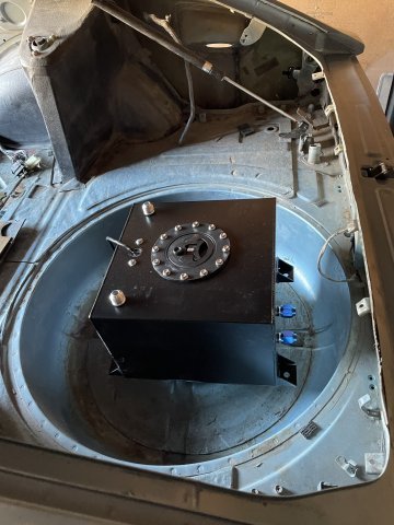

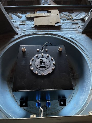

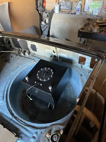

first order of business was to add a fuel cell since i didn't have a fuel tank. Went with a radium 14 gallon unit. Cut the trunk out between the factory frame rails and built a basket. Cleaned it up with some bead rolled panels. plan to add a fill behind the license plate like an old muscle car. -
