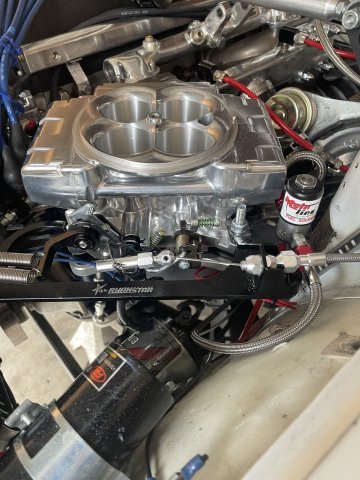

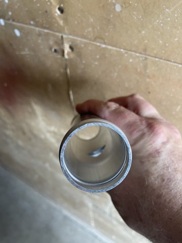

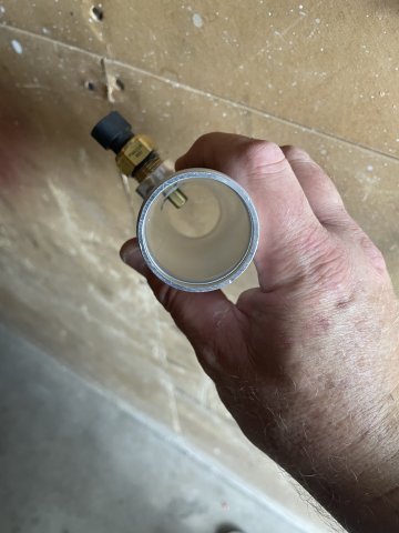

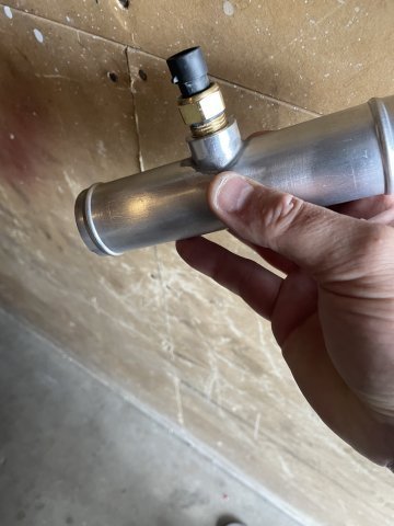

  2. I disconnected my throttle cable and lubed it up, now it moves freely with no drag, in doing so, I re-arranged some of the items attached to the carb thus cleaning it up. A short amount of time to work on stuff today and I'm happy I was able to get it done. Also was able to tighten the spring for the secondary butterflies which is basically required to keep them working right. My thermostat probe adapter that goes into the top radiator hose also arrived and snapped a few pics.

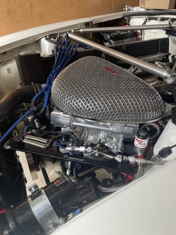

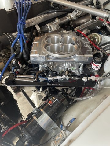

  15. I was able to squeeze in a little time today and build a brace to hold my carb and intake up. Heim joints and all thread.

  20. I got in a little bit of time on the EFI project today. re-ran my water meth lines....the way I had them was problematic.....kept trying to pinch the lines. Also figured out how to run a brace from the engine to the carb intake. I have some heim joints and 3/8" all thread....will come off of one of the 10mm smog pump holes in the block and then up to the bolts in the back of the intake. Small steps.
