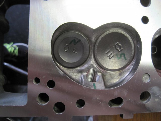

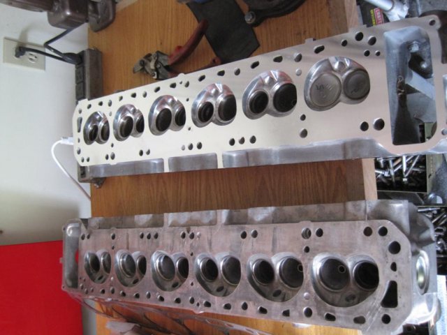

  17. Relating to this topic, my head is about done at the machine shop, but 3 lash pads don't show contact all the way across with a wipe test. It's like the previous issue I had, but we swapped rockers, lash pads and retainers and the wipe is still to one side at the valve. So the valve is not machine correctly, or the top of the valve is not straight? What would be the next step to troubleshoot this?
