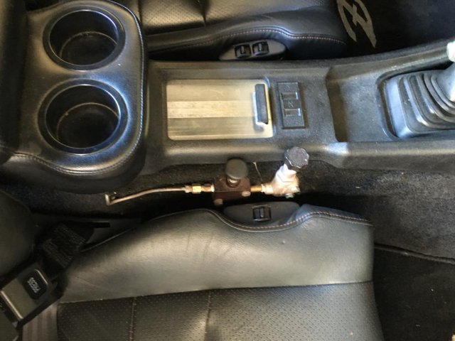

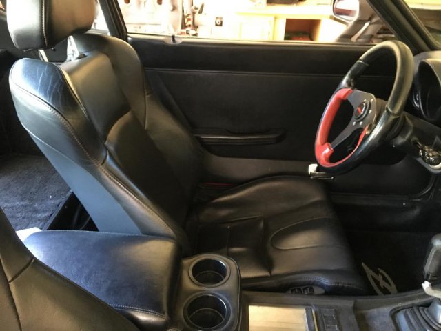

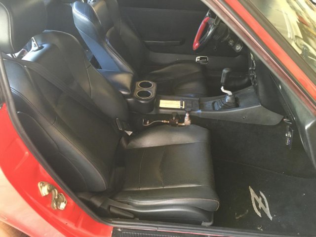

Just finished 350z power , heated , leather seats. Really like the seats and yes it's tight. Managed to get drivers seat low enough to sit in there with a helmet on. I'm 6'2", so pretty happy with that. Yes they are a bit heavy and yes I would have preferred manual seats , but the price was too good to pass up and the stitching matches my car-lol
