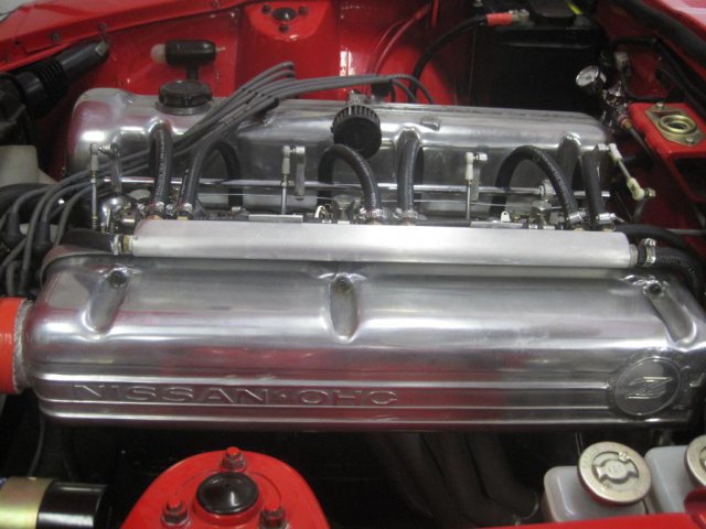

  4. Now if you are looking for the bling factor!!
